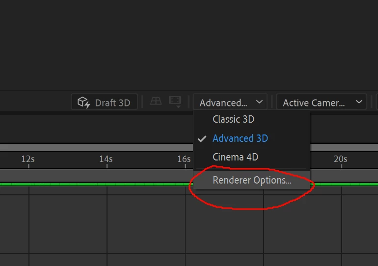

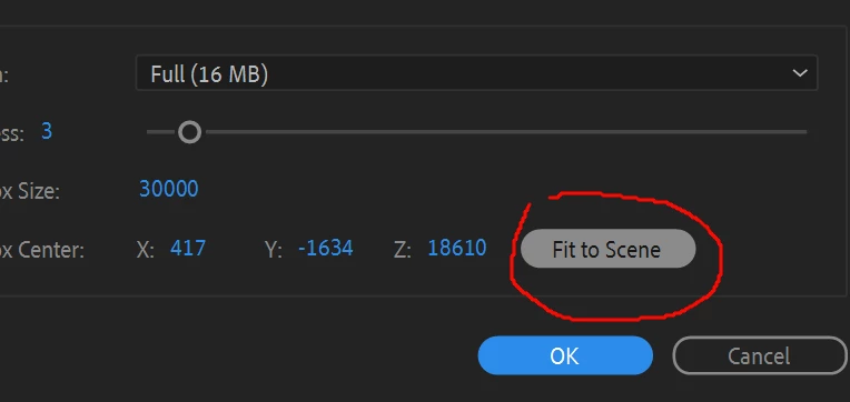

Hello everyone! This helped me:
1.
Then:
After this shadow began to display..
May 21, 2024 11:56 PM UTC
This is the only proposed solution that worked for me.

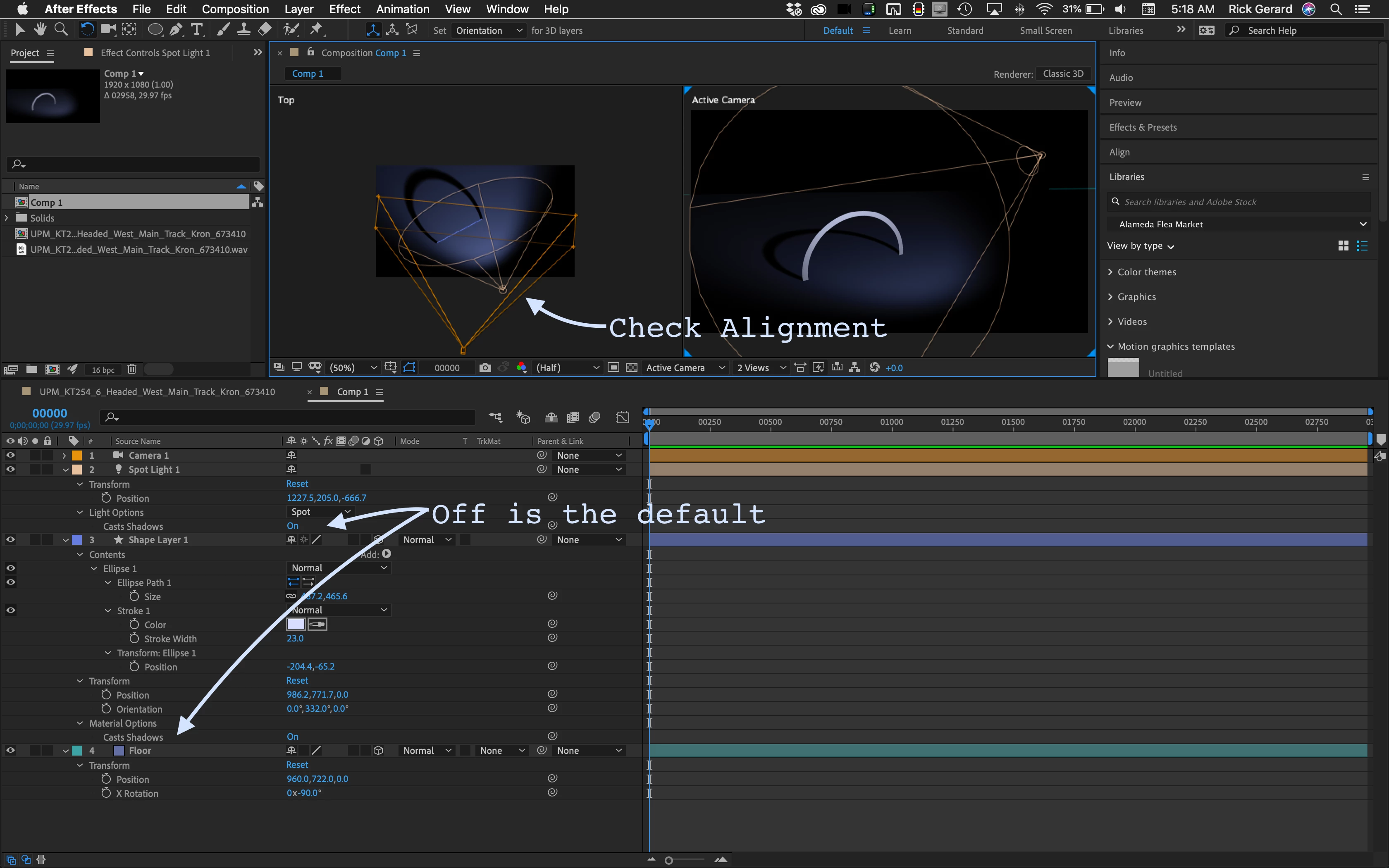

G Alder, we need screenshots of your comp with four views so we can see the alignment of the layers. If you are using the C4D rendering engine, shadows are limited. If it is something else, a screenshot showing the position of the lights, the camera, and the layers should point out the flaws in the layout.

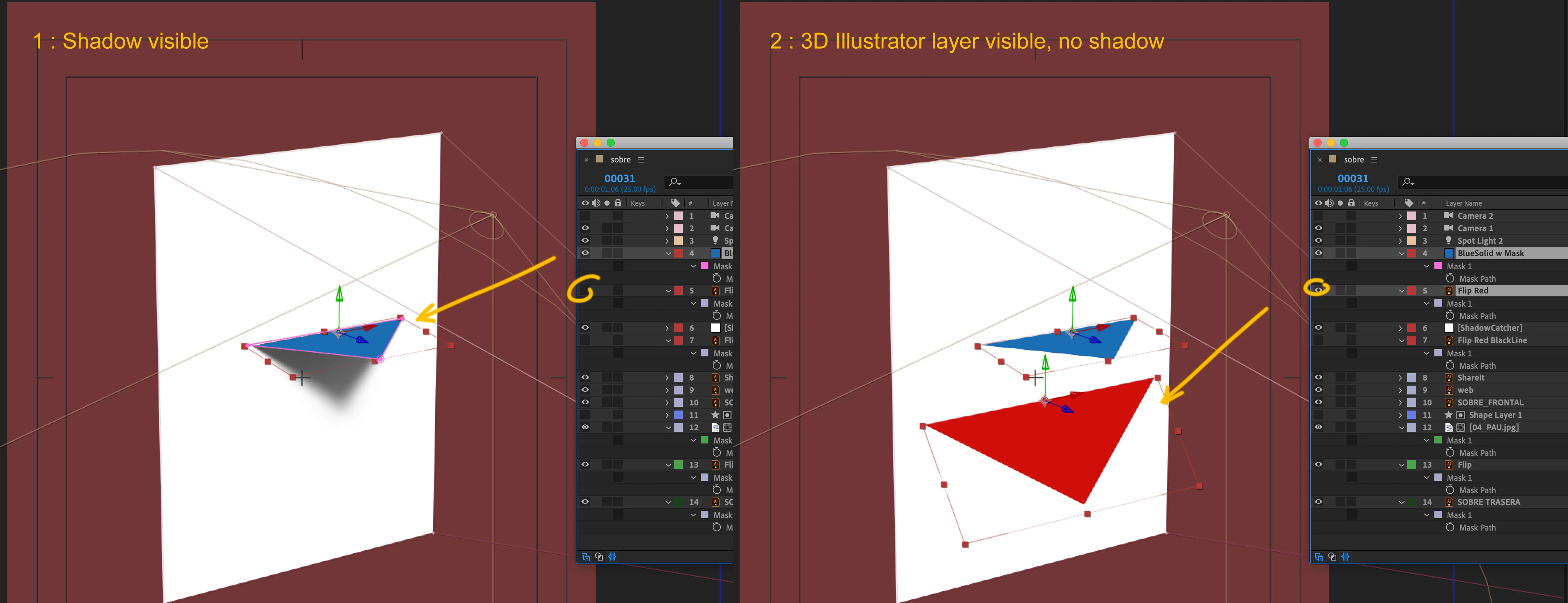

Dec 1, 2021 1:14 PM UTC
We might be having a similar problem here.
In out case an ADOBE ILLUSTRATOR LAYER (tldr) was causing the problem.
We created another solid, which would cast shadows if said Illustrator 3d layer was not visible and in between the light and shadow catcher.
If the Illustrator layer was visible or inbetween in the layer stack; no shadows.
Said layer has a Fill Effect and a Mask, but does not cast shadows when these things are deactivated.
Seems like a BUG to me.
Still twiddling with things to figure out what the issue might be and how to fix it, but I'll most likely parent a solid with the same shape of the illustrator layer to cast the shadow.
gregdigg
Dec 28, 2021 5:16 PM UTC
Have you tried pre-comping the illustrator pieces?

Select all your 3D layers and lights, press the U key twice. If you don't see Cast Shadows on for lights and layers, you won't get any shadows. The default for both lights and layers is Cast Shadows Off. You also need to check at least two views to make sure your lights are in the right location and pointed the right way to cast a shadow. If you don't see Cast Shadows - On, then select the layer and press aa to reveal the material options and make the adjustments.
