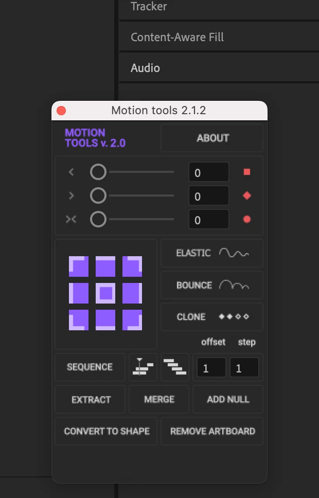

I have just re installed after effects and scripts on a new mac, but cant seem to doc the scripts into my workspace, they just pop up but cant dock.
Any help would be greatly appreciated.
thanks
Correct answer Mrtn Ritter
There is a ScriptsUI folder within the scripts folder. All scripts which are actually dockable panel must go into the ScriptsUI folder. Sometimes, scripts are provided as a window (the one in the screenshot) and dockable panel.
Make sure to launch the dockable script from window menu, not file -> scripts.

That’s fixed. Thanks very much 🙂
