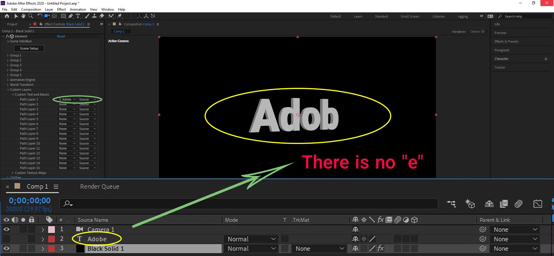

Hi there guys! I recently started working with Adobe After Effects, Element 3D and Saber plugins!
but when i wirte text and go to Custom Layers-Custom Text and Mask - and put my text (for example i write (Adobe)) in path layer 1 source then go to the Element 3D and extrude it !
It will be extruded but just (Adob) extruded and letter (e) is missing . same problem in Saber.
in after effects 2019 and 2020 tested. with last element 3d realese...
see the attachment!
Thanks for your help...

I had the same problem and figured it out.
You should change the paragraph settings to this: 

I have this same problem. I have to type an extra letter, and then delete it, to show my desired last letter.
AE Version 17.7.0 (Build 45)
Text engine was already set to Latin.

I had the same problem and solved it.
You should change your text engine under "Preferences"- "Type" - "Text Engine". Change it to Latin.
Than Close your project and rewrite your text in a new layer and add the "Saber" effect as usual.

October 26, 2020
Did not work for me. I have the same problems after using Adobe Font Kit.

Just add a space at the end. I believe this is a bug since Adobe changed something in the mask stuff in recent releases vs. E3D and Saber literally not having been properly updated in years, at least the publicly available builds.

By typing an extra letter like "Adobee" It will be solved but I didn't want to use this way.
with adding space at the end , the problem was not resolved.

I would recommend to change the font to some others to make sure about whether the same problem happens or not.
January 9, 2020
I changed the font, but it didn't work

Have you tried to update the graphic card driver to the latest?

Does the missing Last Letter issue only occur with these two plugins? If this is the case, you should then get in touch with Video Co-pilot.
Meanwhile, to workaround this issue, simply type in an extra letter. HTH

I tested on these two
