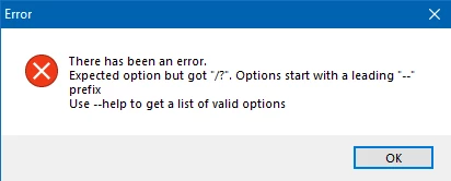

Running "uninstall.exe /?" gives us this error window:

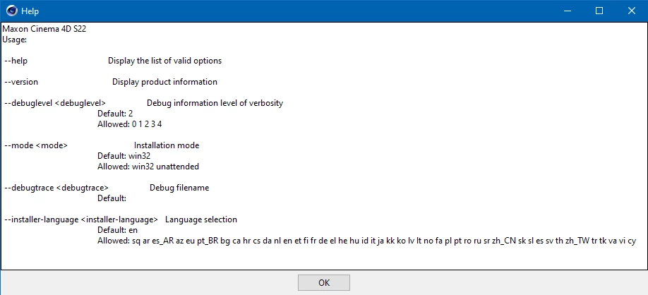

Running "uninstall.exe --help" gives us this window:
Thank you so very, very much for the support Adobe  😛  Perhaps this could be added to the "--help" documentation in the future. . . .
