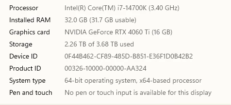

    sept. 24, 2026 4:21 PM UTC
    Could you share your system specifications? This is kind of a demanding task.
    Traduire

    Nishu Kushwaha
    sept. 25, 2026 2:25 PM UTC
    Thanks for sharing the specs, your system looks fine. I think the bottleneck is really just the sheer scale.
    My recommendation would be to break the shot into smaller chunks (500–1000 frames each), matte each segment separately, and queue them as separate renders. That way you can process overnight in stages, and if propagation drifts on one section, you only redo that chunk rather than the entire shot.
    Let me know how it goes.
    Nishu
