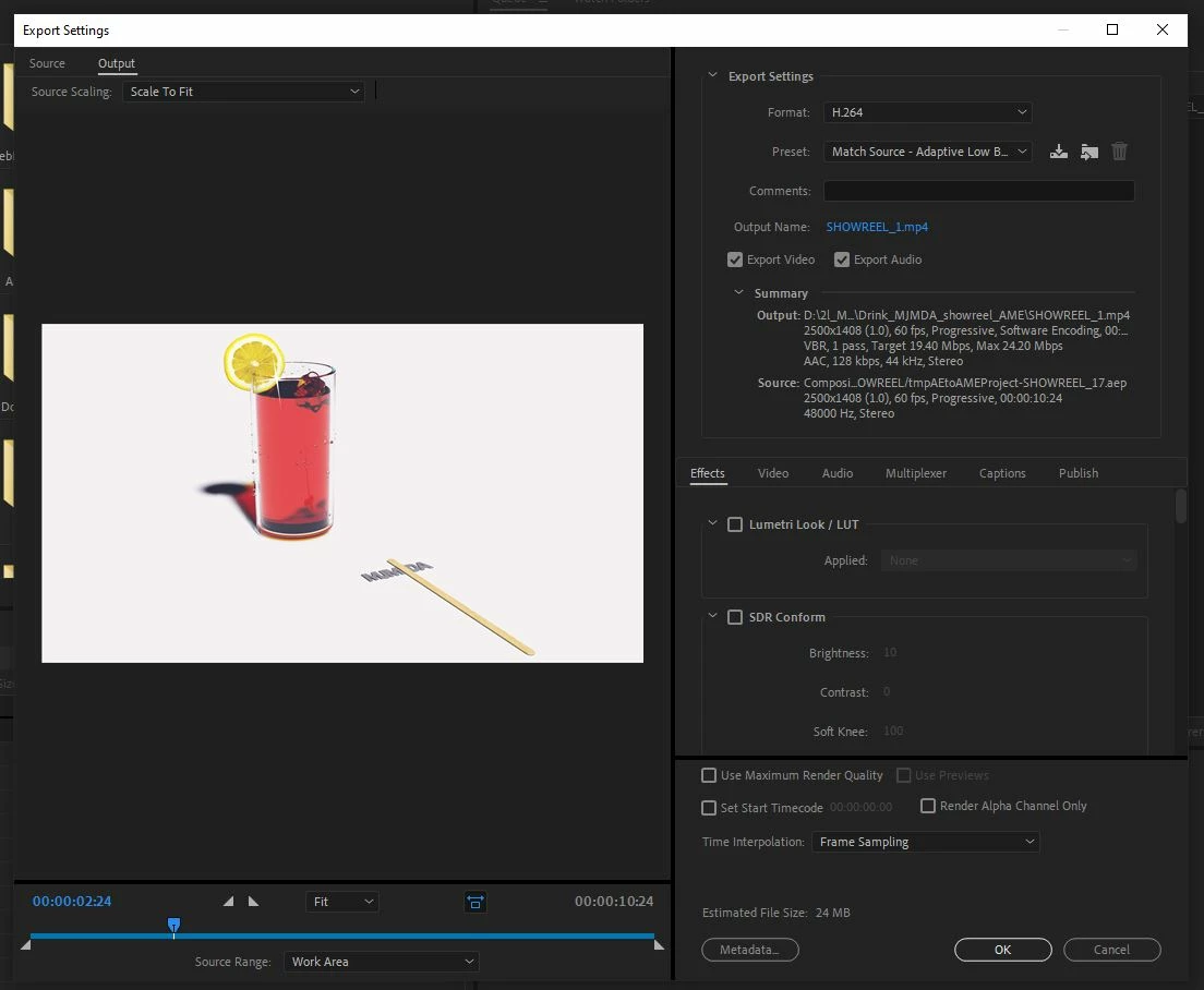

Hi everyone,
When I try to export with Adobe Media Encoder, the colours of a layer are completely offset, as you can see in the attached image.
The layer in question is nothing more than a copy of another one that is located at the beginning of the animation, but positioned within a "pre-compose" group.
If, on the other hand, I export with the classic Render Queue, the problem does not occur, the image is perfect.
What could be the cause of this problem?
The first attached image belongs to the beginning of the animation, where the colours are as they should be.
The second image is from the end of the animation, where the colours are completely offset.
In the preview in After Effects, the colours appear perfect throughout the animation.

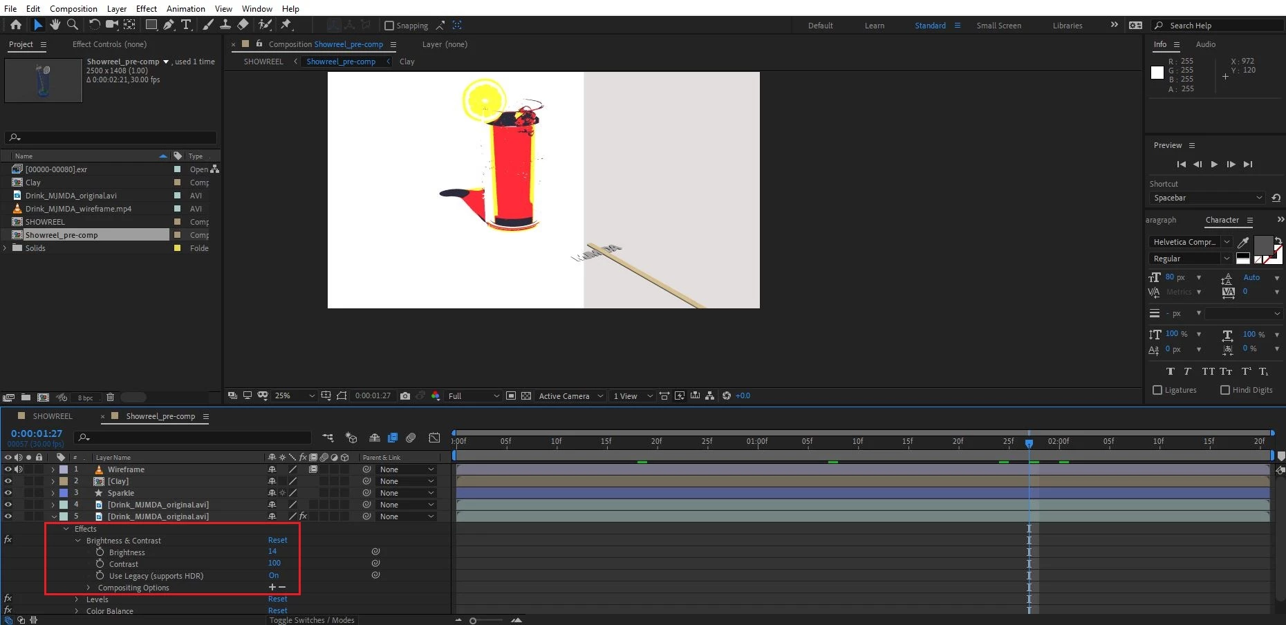

November 4, 2021
Ok I have just realised that the problem does not seem to be solely related to Adobe Media Encoder.
I just reopened the file and the "offending" layer appears corrupted in colour.
To restore the image to its original condition I have to click on "Reset" in Brightness & Contrast in the Effects applied to the relevant layer and then reapply the same values as before (see file attached)
However, when I go to export with Media Encoder, I still have the same problem (and not with Render Queue).
I just don't understand where this damn problem comes from.
As described before, I used the same layer with the same image and the same effects applied at the beginning of the animation, and everything is fine.
I have also tried copying and pasting the correct layer into the pre-comp where the corrupted one is, but again I get the same result.

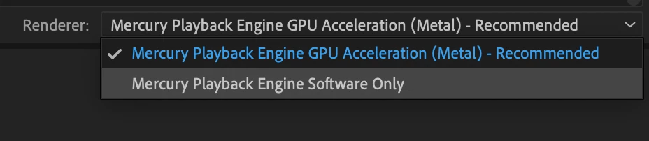

try to export using software only, maybe it's a GPU problem,
