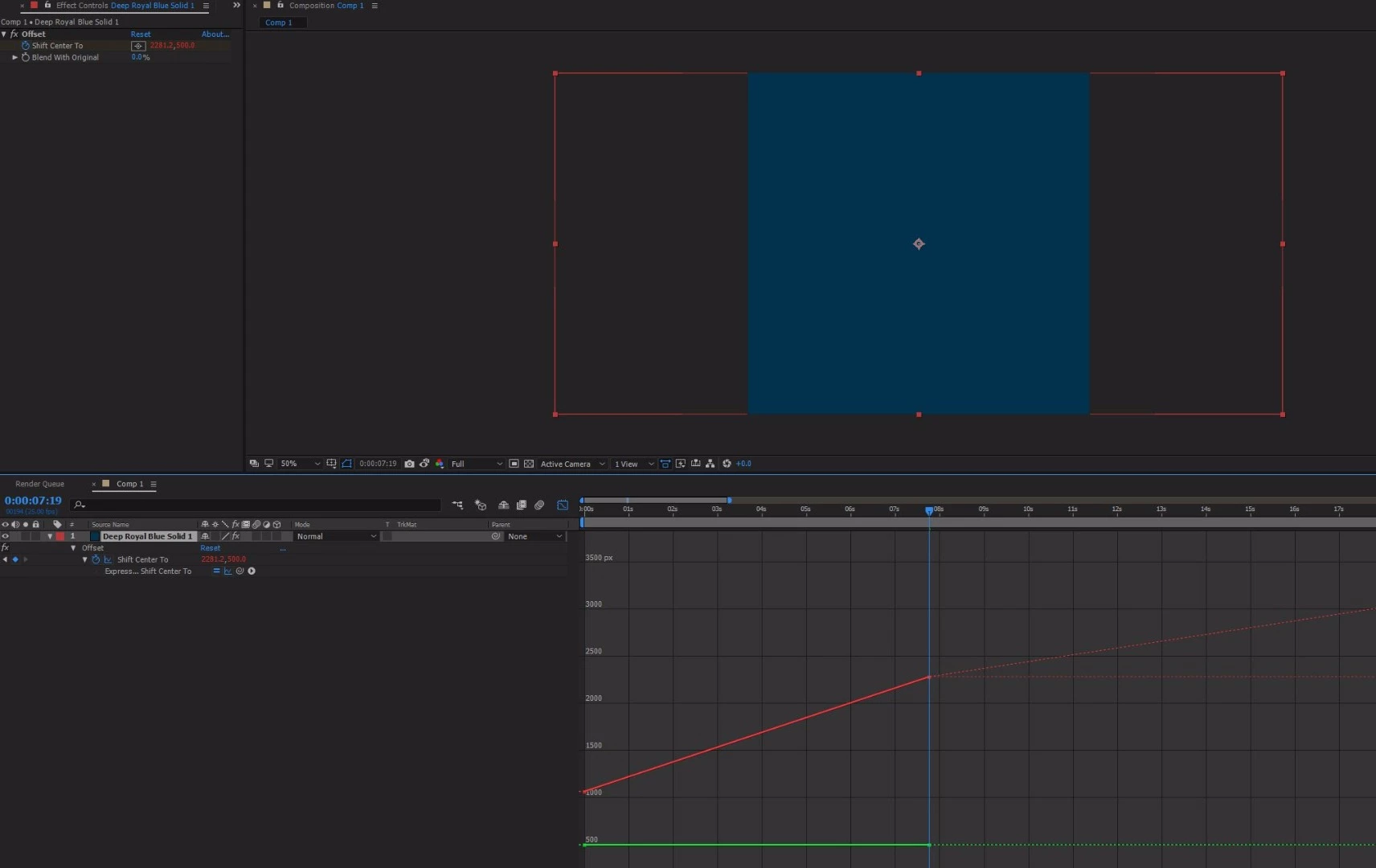

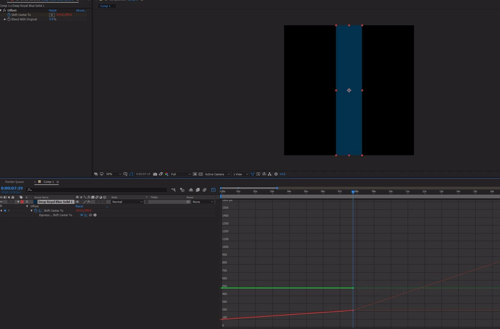

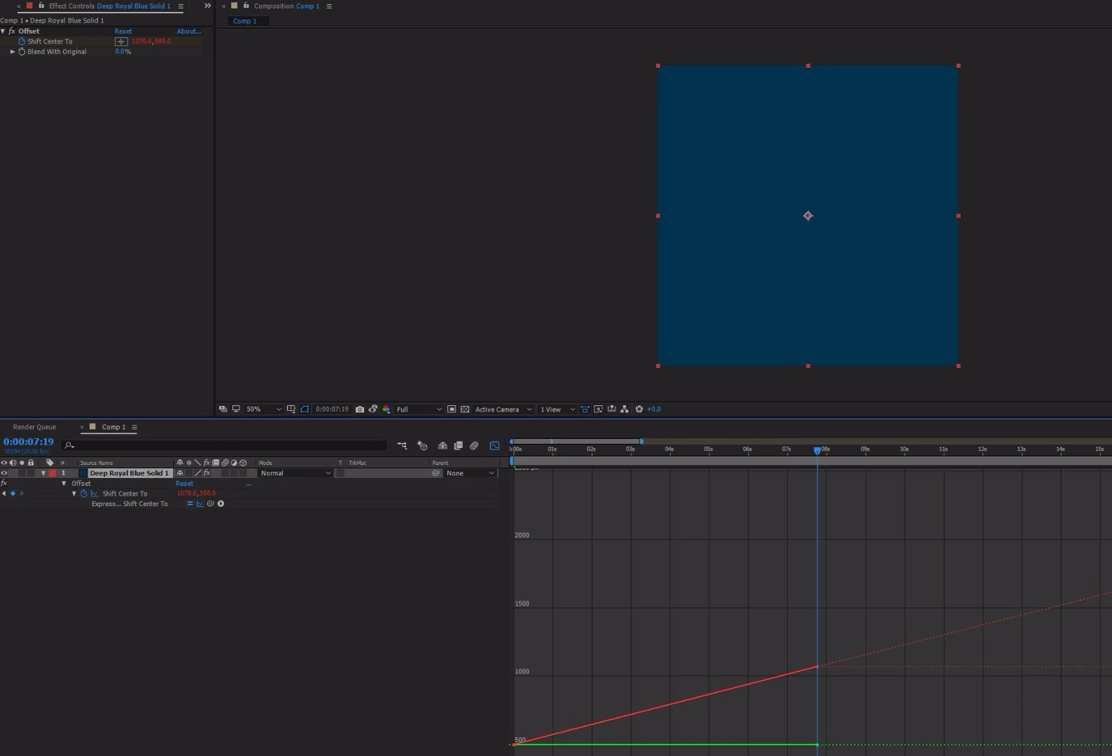

Im trying to use LoopOut("continue") expression on the Offset effect, AE 2017.
The problem is that it seams the continue loop has some relation with the Comp size vs the Layer Size.
If ratio is the same the offset effect continues at the same speed, If ratio is smaller or bigger the speed is smaller
or bigger respectively.
Does any one has a solution?
Thank you

Per the issue with the loopOut("Continue") :
     I was able to replicate your issue, I'm unsure as to whether it would be considered a bug or not.
If you use : loopOut("offset")
     Your progression will remain linear regardless of the layer resolution.

Hey Coresmith, would be helpful to have more info on what you're attempting to achieve with this.
From the looks of your images, it may be more prudent to use a time based expression if you want the value to increase perpetually (ie. [time*50, 500]
CoresmithAuthor
August 3, 2017
Thanks, that was a grate suggestion.
I also reported that behavior as a bug as I still dont understand
why it considered as an usual behavior(?)
Thaks again

Mylenium
July 31, 2017
Effects are always relative to the layer size. Of course this will affect certain calculations. Nothing unusal here.
