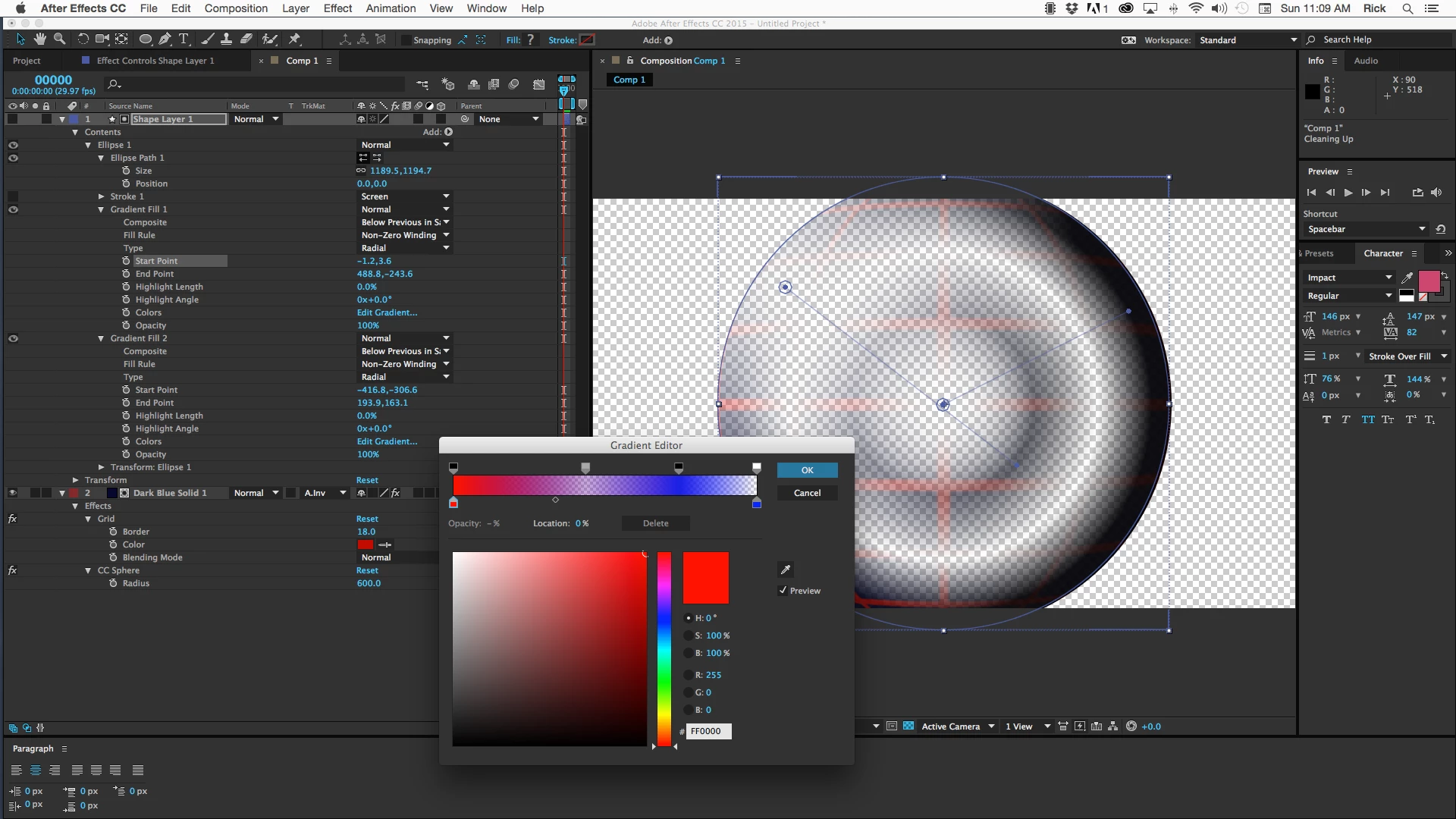

    Whenever I need to generate a gradient for a track matte I use a shape layer instead of a solid with a gradient because there is no need to pre-compose and you can combine multiple gradients, colors or shapes. Heres one with two radial gradients with AE's panels arranges so you can see the layer properties, the gradient editor and the resulting comp. I've set the track matte to alpha. This is much more versatile, easier to edit and faster to render.

    Thanks for that tip. Having some trouble getting the gradient to do what I want but that's easily sorted!
    Cheers
