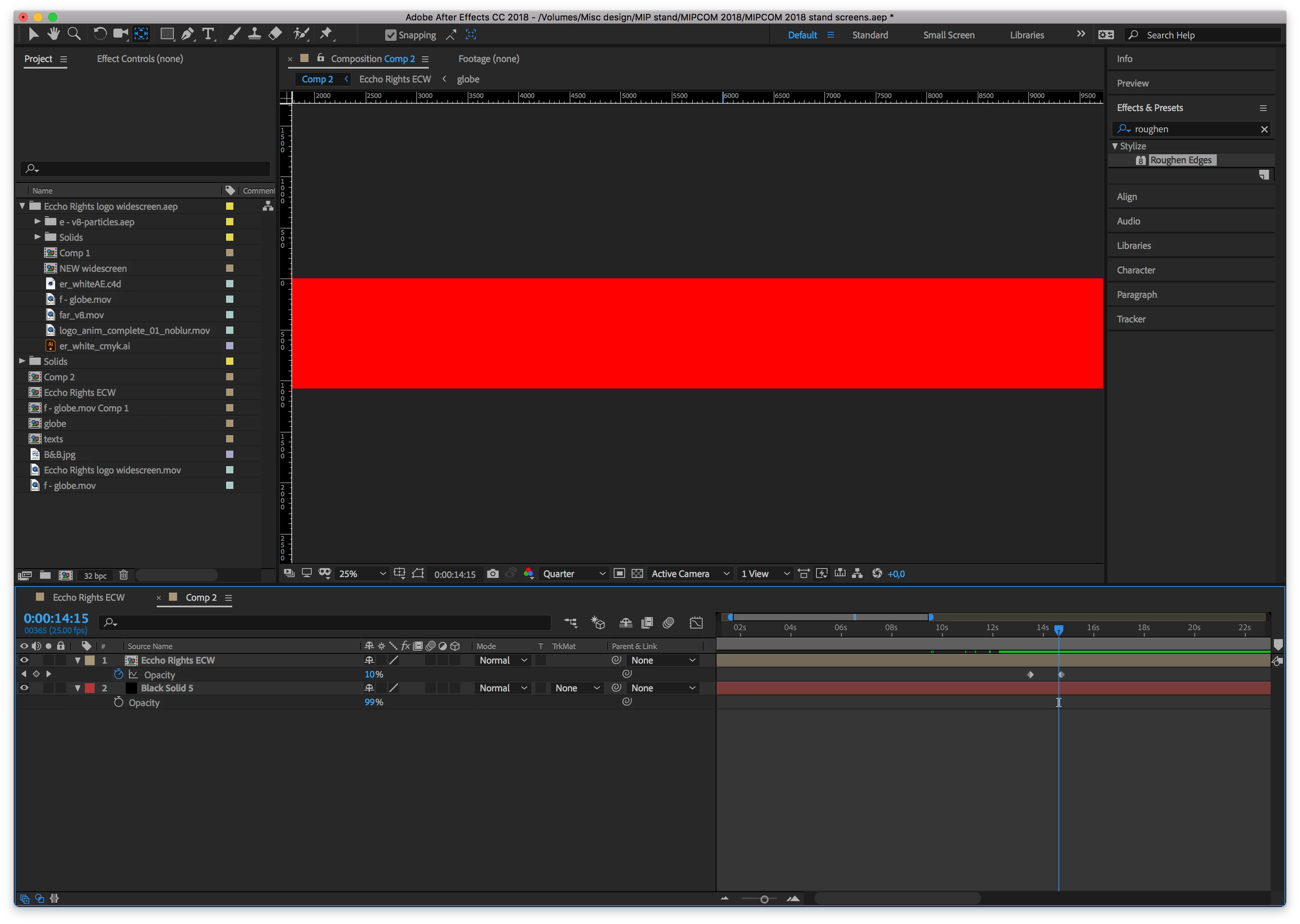

Hello! I'm working with what I think are quite basic elements in an AE project but something keeps happening that is really foxing me...

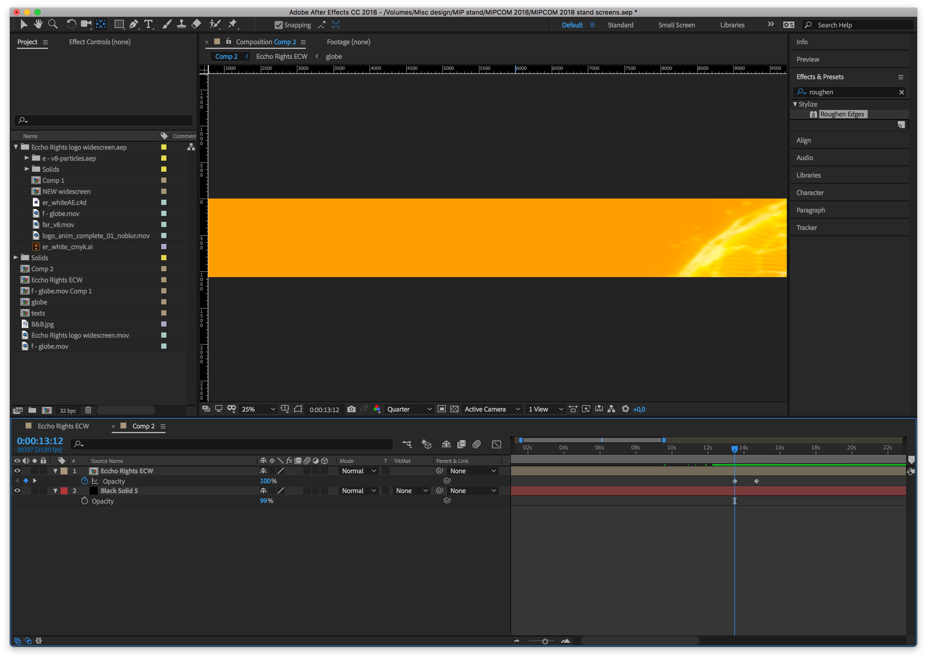

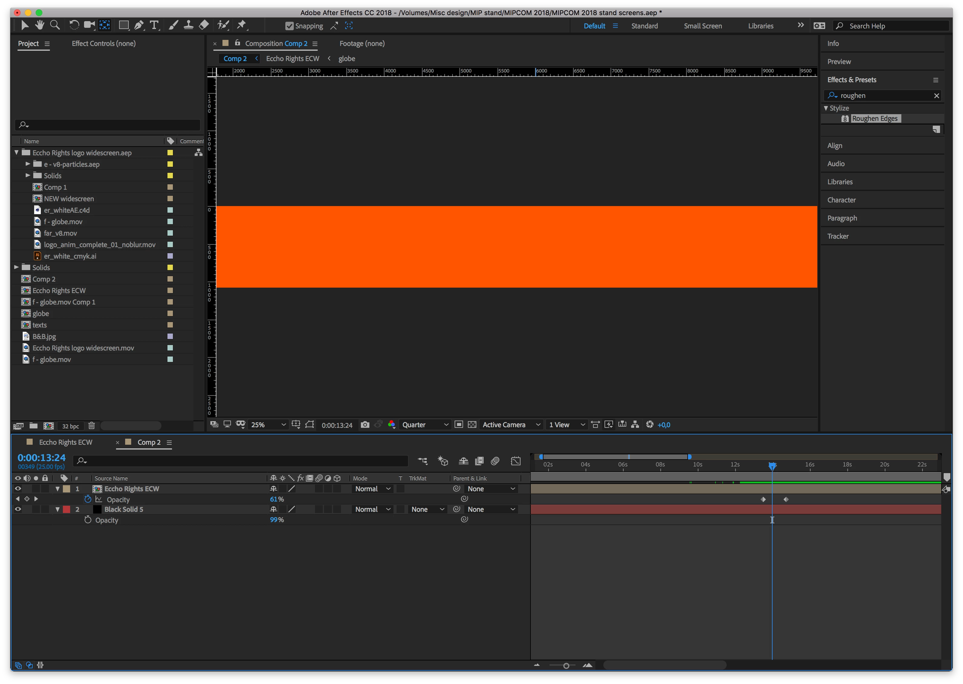

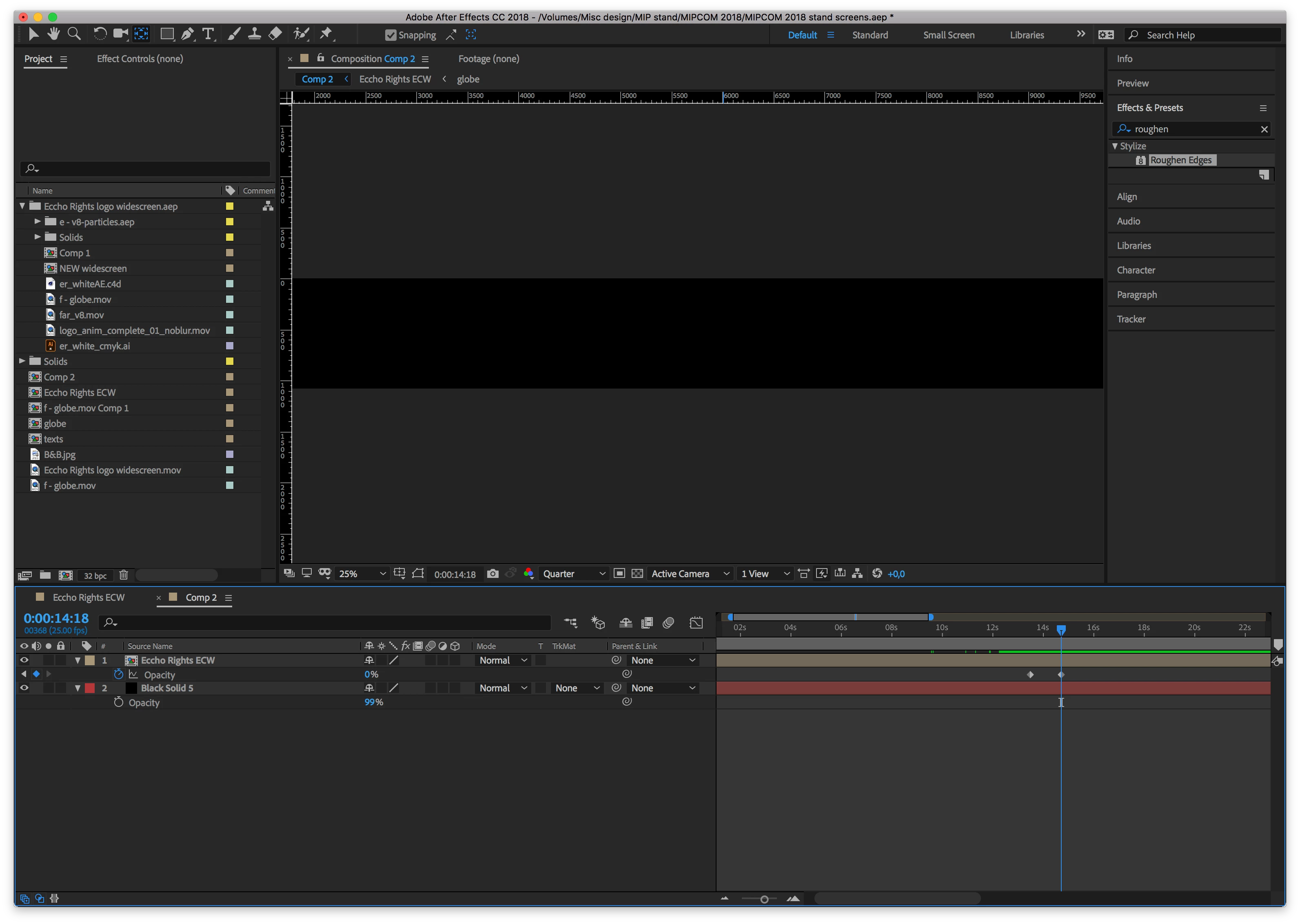

Every time I change the transparency of an object, regardless of what it is - precomp, solid, shape, text - as I change opacity the object goes through what seems to be some kind of blend with an underlying red, before finally at 100% becoming solid, and not showing this red at all. This is quite hard to describe but I am attaching a series of screenshots with the top layer at 100% opacity, 61%, 10% and finally 0%.

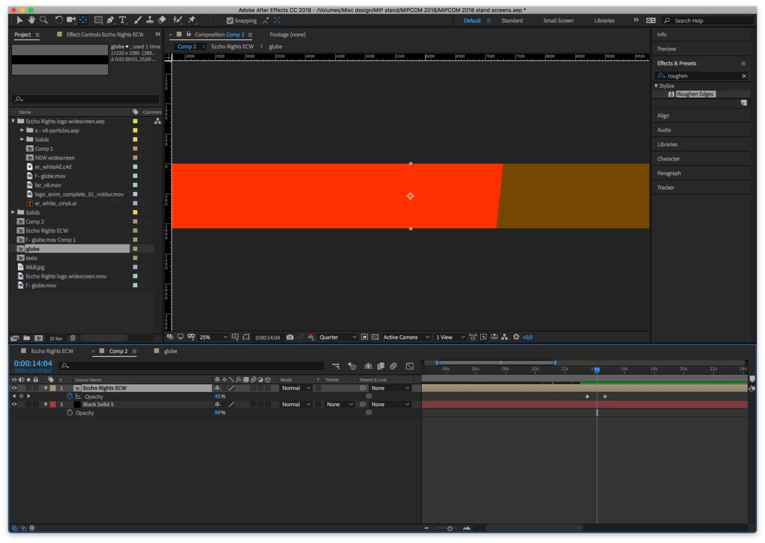

Within the pre-comp Eccho Rights ECW there is a further pre-comp, and within that there is a Keylight applied. If I switch it off, then I experience a strange phenomenum where the previously Keylighted part of the pre-comp fades to black as expected, but the remaining area continues to go through red (next image).
What am I missing team?? Very grateful for any help anyone can give!
