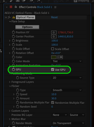

Warren Heaton
Aug 1, 2023 6:42 PM UTC
@Joe_hance
Try opening a project that uses Optical Flares with caps-lock enabled.  Locate the GPU parameter for Optical Flares and uncheck "Use GPU".  Save and then release caps-lock.
This has helped me with unexpected crashes with effects that use the GPU until I've been able to sort out the display driver.
Joe_hanceAuthor
Aug 2, 2023 1:46 PM UTC
Thanks for that hint, but nope, didn't work. I tried it, but AE crashed before the project even opened. As soon as AE realizes, that there is Optical Flares involved, it denies and crashes 😄 It's not crashing when loading a frame which uses OF, it crashes before...
Warren Heaton
Aug 2, 2023 5:44 PM UTC
If it crashed, I'm guessing you never got as far as unchecking Use GPU.
Try opening the After Effects project without any source footage (so it all shows as missing) to see if you can get to the Use GPU setting.

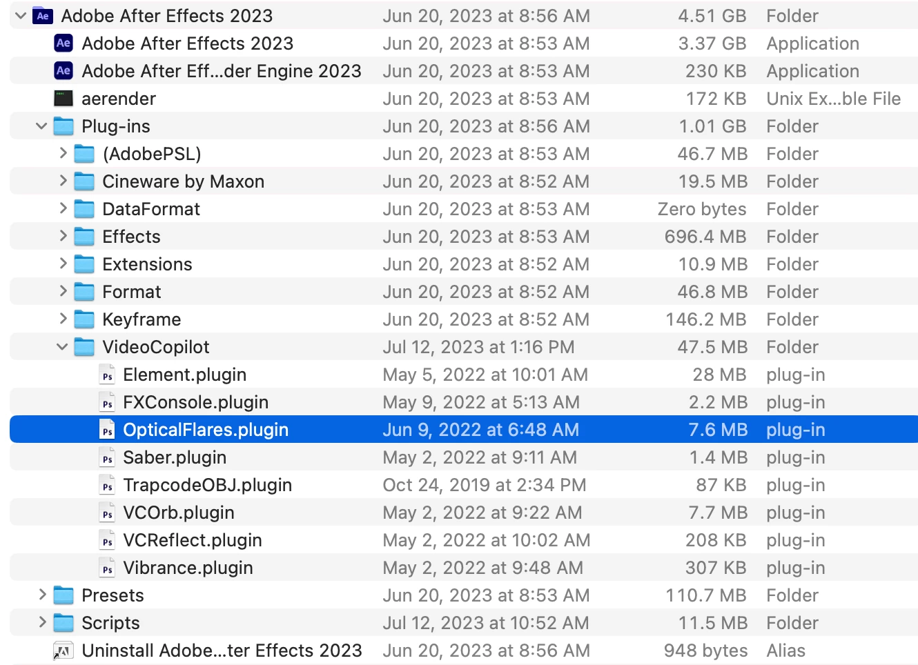

Jul 27, 2023 8:34 PM UTC
Have you tried installing the latest version of Optical Flares from Video Copilot? It's working fine on my M2 Mac.

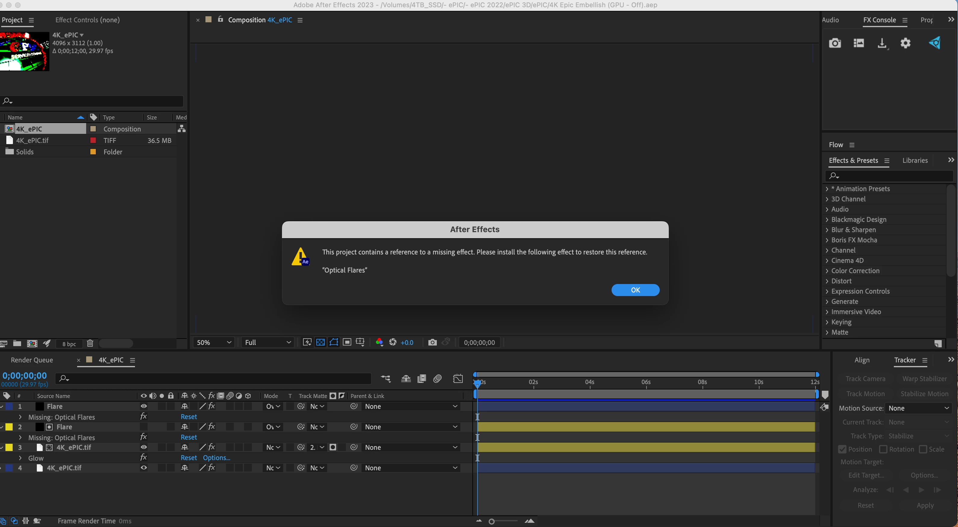

CSI Productions
Aug 2, 2023 4:13 PM UTC
I'm using VC OF 1.3.8 with iMac AE 23.5.0 and the file with a flare applied opens but with a warning that a plugin is not installed - but it is.
