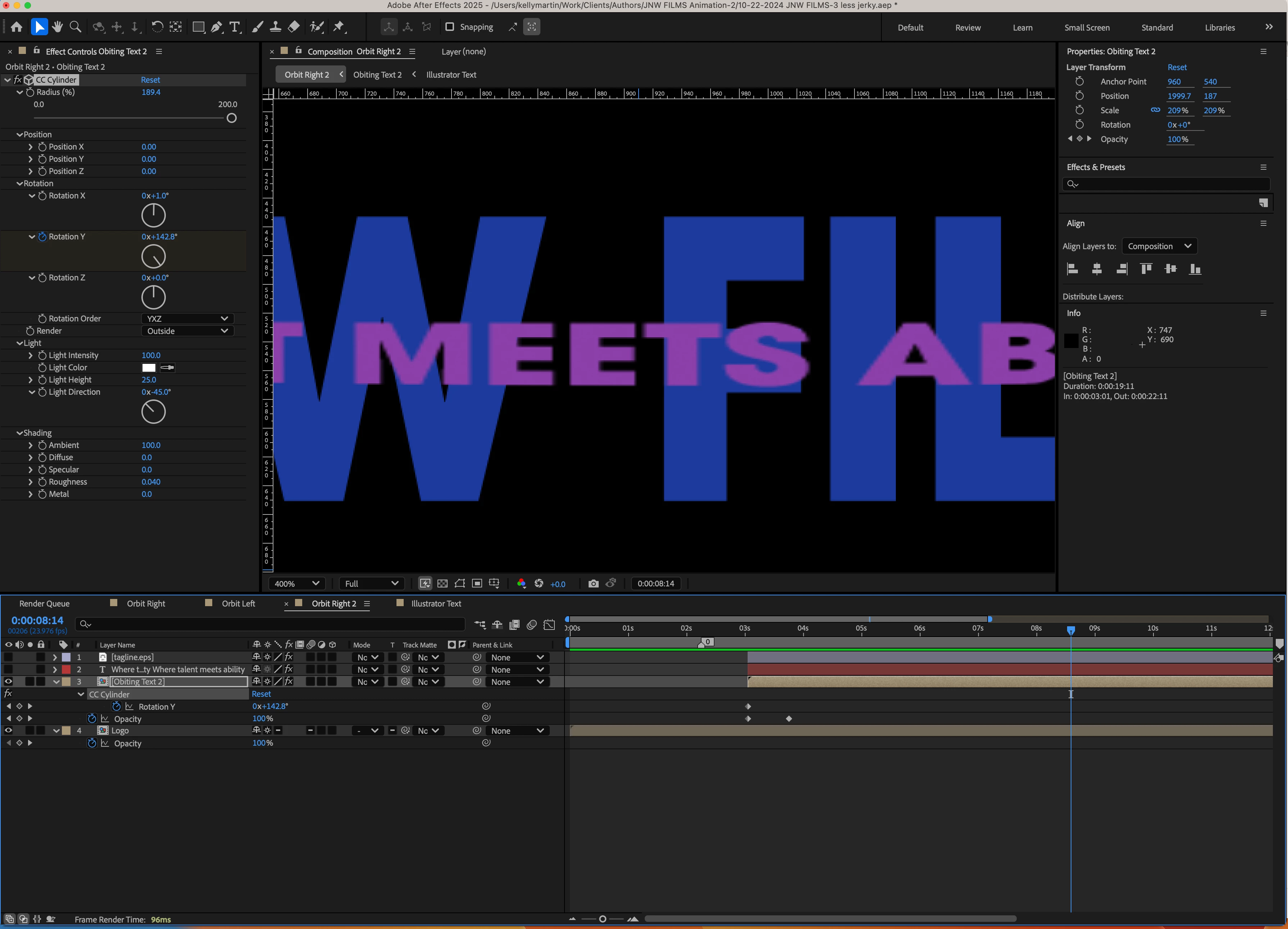

October 23, 2024
The raidus you have set on the CC Cylinder is above 100%, which means the text is now getting scaled at the rasterized pixel level. The text will never be sharp with a radius above 100%.

October 23, 2024
Here's the screenshot.
Thank you for your help jenkmeister!!

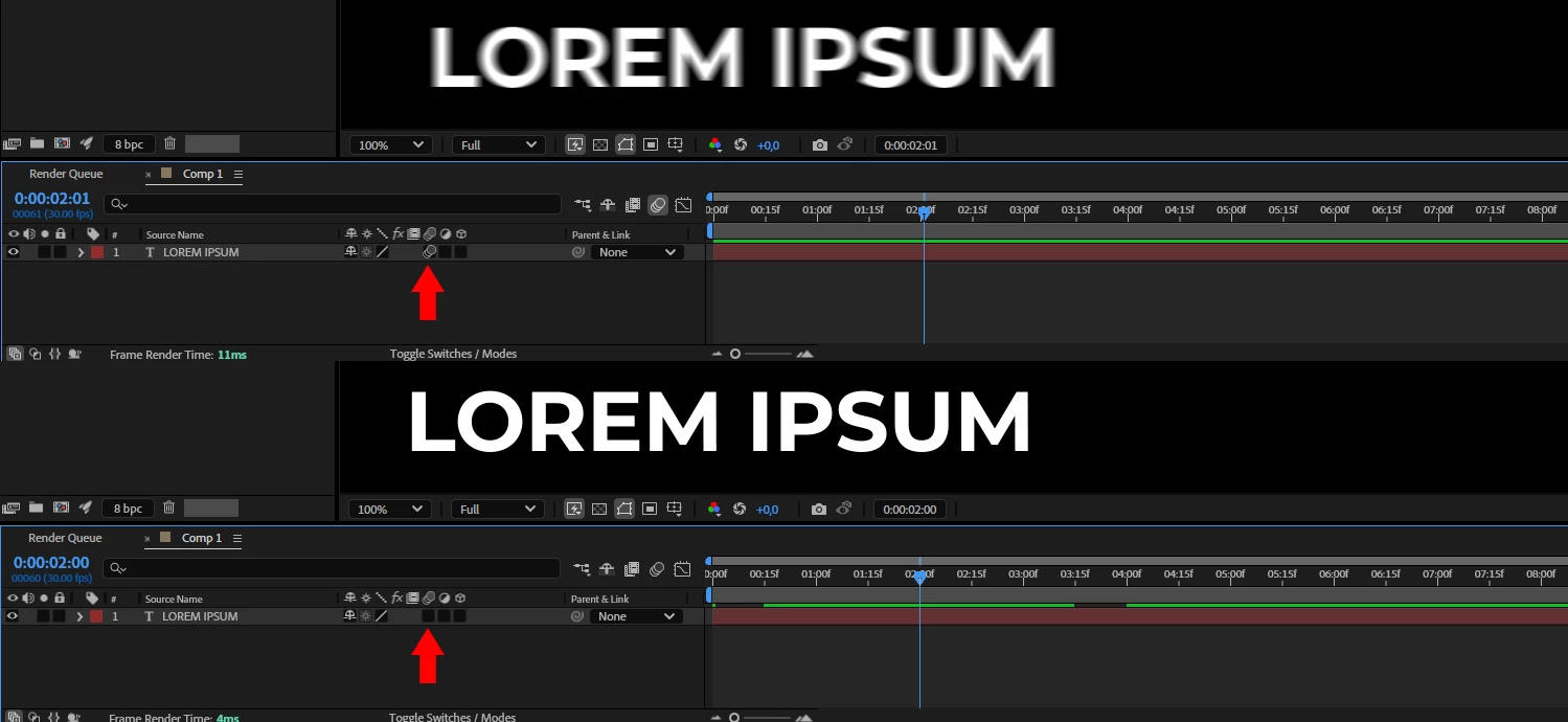

October 23, 2024
Isn't the motion blur enabled?
