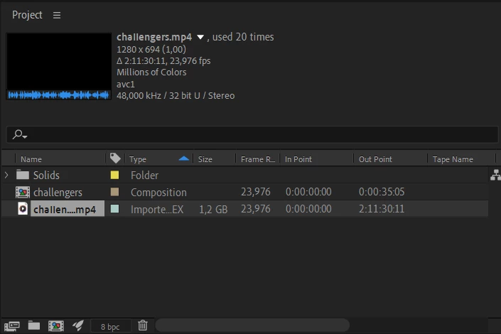

If you select the source footage in the Project panel and take a screenshot of the Poster Preview at the top where it shows a thumbnail, the filename, the frame rate, and the duration, that will be helpful.
If it's a blended frame due to long-GOP source footage, you could transcode the source footage to ProRes 422 LT outside of After Effects, maybe even with After Effects, and then use File > Replace Footage to swap out the current file for the new one.
If it's a pre-existing cut in interlaced source footage that has not had the 3:2 pulldown removed. you can go into the Interpret Footage dialog box and remove the 3:2 pulldown.  There are five cadence options for whole frames (W) and split frames (S), so you may have to try more than once while checking the source footage at multiple pre-existing edit points.  Also, if working in a Composition that's running at 29.97 frames per second, you'll have to change the Comp frame rate to 23.976.
bratzweigAuthor
Oct 26, 2024 6:49 PM UTC
Here's a screenshot. I'm gonna try this and come back thank you.
