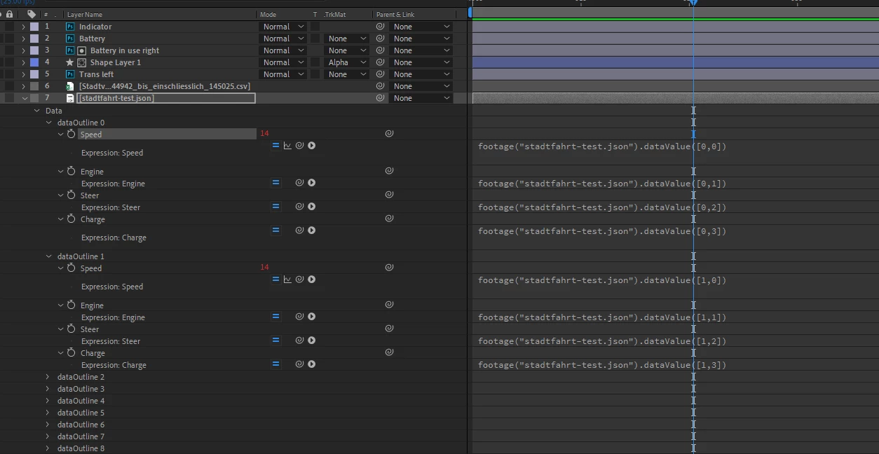

    In After Effects it finally looks like I could work with those values:
    You see After Effects interprets the JSON file in a two dimensional way: dataValue([x,y]) whereas x represents the number of entry and y stands for the entry's parameter (0 = speed, 1 = engine, 2 = steer, 3 = charge)
    Now the most basic thing I want is to have my text layer in after effects just show me the "speed" value. But it needs to change according to this JSON table. So for instance, if I look at frame 0 in my comp the text value should display the very first speed value taken from the first entry of the JSON file (which is called "dataValue([0,0])" in After effects. When I look at frame 136 the text should grab its value from "dataValue([136,0])"
    I could pick whip the text layer's source parameter to one of those values, but then I only have one constant value. I somehow need to map it to the second dimension ("x") and tell After Effects the first dimension ("x") should always be the same as the current frame the comp is in.

    Once imported to after effects I put the JSON file into my comp, which then looks like this:
    I figured, the first dataValue inside the brackets refer to every one of those entries of the value "Speed" inside my JSON file. But now I don't know how to map those 50 values per second to my graph. I have built a simple graph which goes from 0 to 100 percent so I guess I could just pick whip this value to the speed value which I somehow have to transform into percentage.

    Unfortunately AE doesn't automatically understand a normal JSON file as "a set of values over time", it sees it as an array of objects, all with fixed values. Connecting the values to the movement of something on screen has to be done by hand, using expressions or pick-whipping. There's also no point-and-click solution for making a graph.
    https://lesterbanks.com/2018/09/animate-multi-line-chart-ae/ covers the workflow involved. Whether the data is controlling the X/Y position of a dot, or the content of a text layer, makes no difference.
