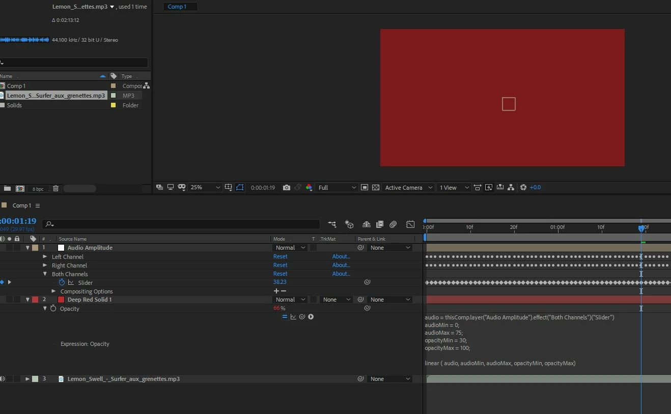

    Can you share some screenshots of what you're trying to do?
    This expression works correctly when applied to an Opacity property. Are you applying it to a property with more than one value, like Position, Scale, etc.?

    Here is: Imgur: The magic of the Internet
    For the Particles I dont use any effect, just the opacity.
    I'm using some effects like position, scale but for the text. Which is in a pre-compose group.

    Well, I'm not sure what you're encountering here. I copy/pasted the exact expression from your post, and it works correctly.
    Are you applying your particle effect to this .wmv? Or just using that for testing purposes?
