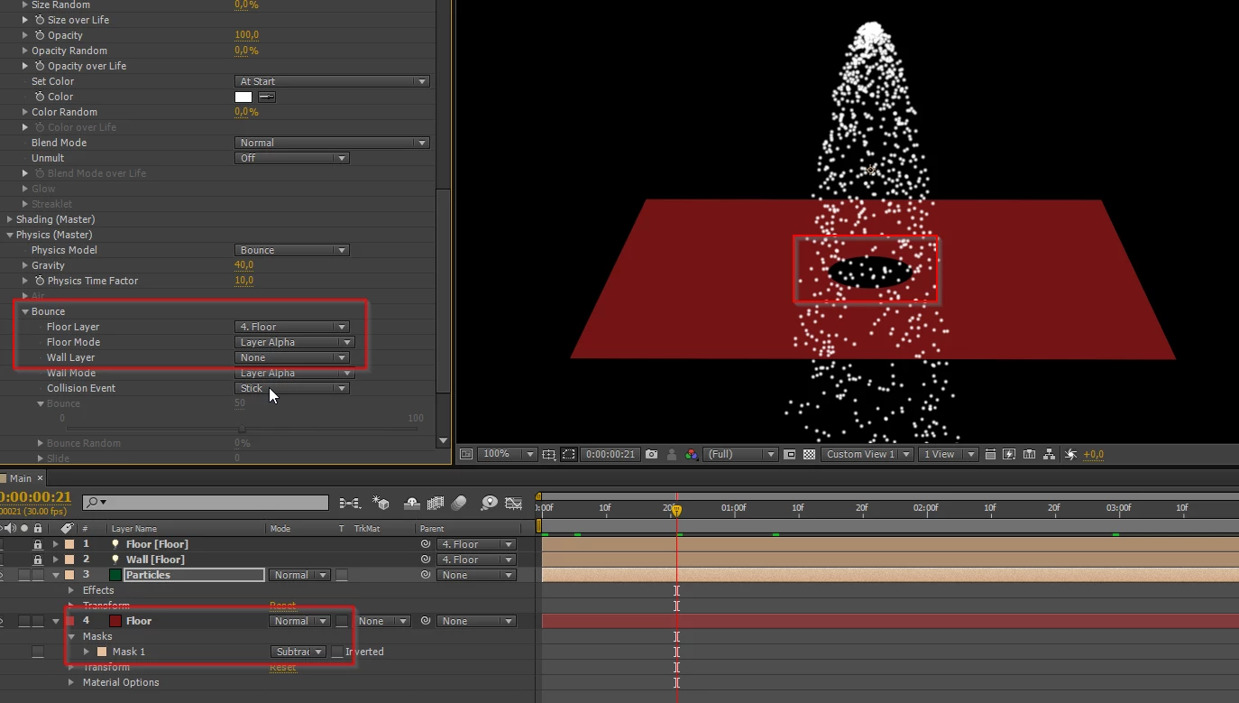

I try to make a simple thing : Generate many particles, bouncing on layer (a floor)... but passing through a hole (designed by a mash, but maybe it's not a good choice).

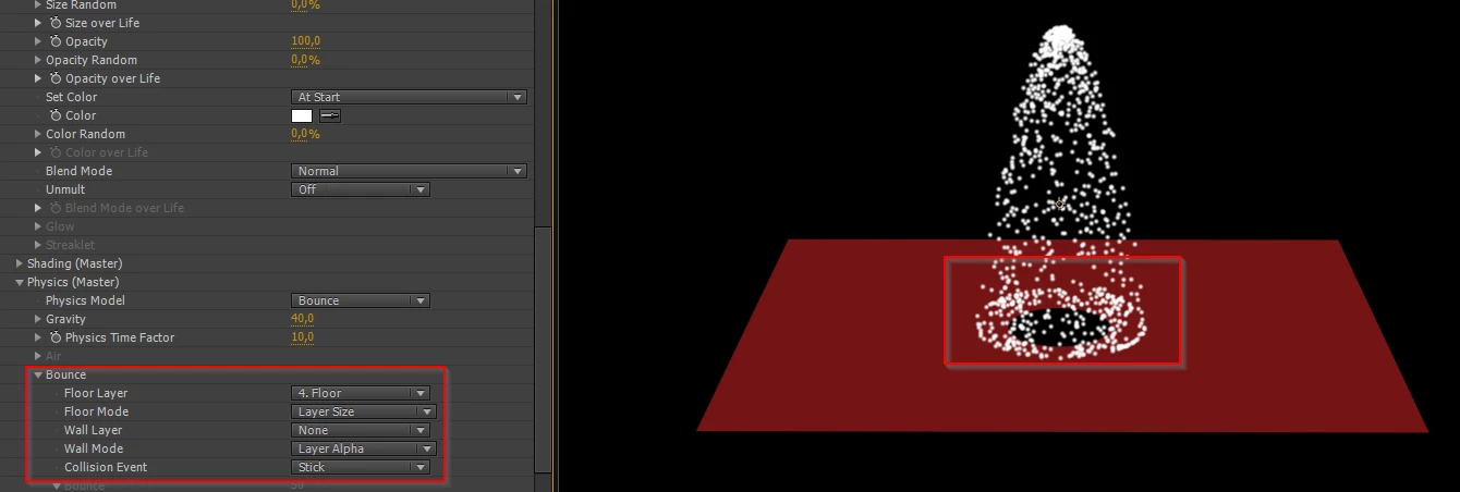

If i select following option :
It's ok when i select "Layer size", particles are sticked, but hole isn't taking in account.
I made a try with the option "Layer Alpha", but floor and hole are ignored.
Have you got an idea ?
Thanks for your help !
    Mylenium
    October 6, 2019
    Not possible with Particular. You need to use another plug-in like Stardust or switch to another program. However, if you just want to funnel particles through a hole you could try and fake it with the radial field with a very strong negative force setting and placing it strategically...
