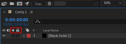

Maybe try soloing your layer or locking all the other layers.
At least this will prevent your mouse from interacting with unwanted layers.
Jul 21, 2024 11:11 PM UTC
Just tried both and no luck... I also just completely uninstalled AE and reinstalled it so that rules that out 😞
Thanks for the suggestion though!
