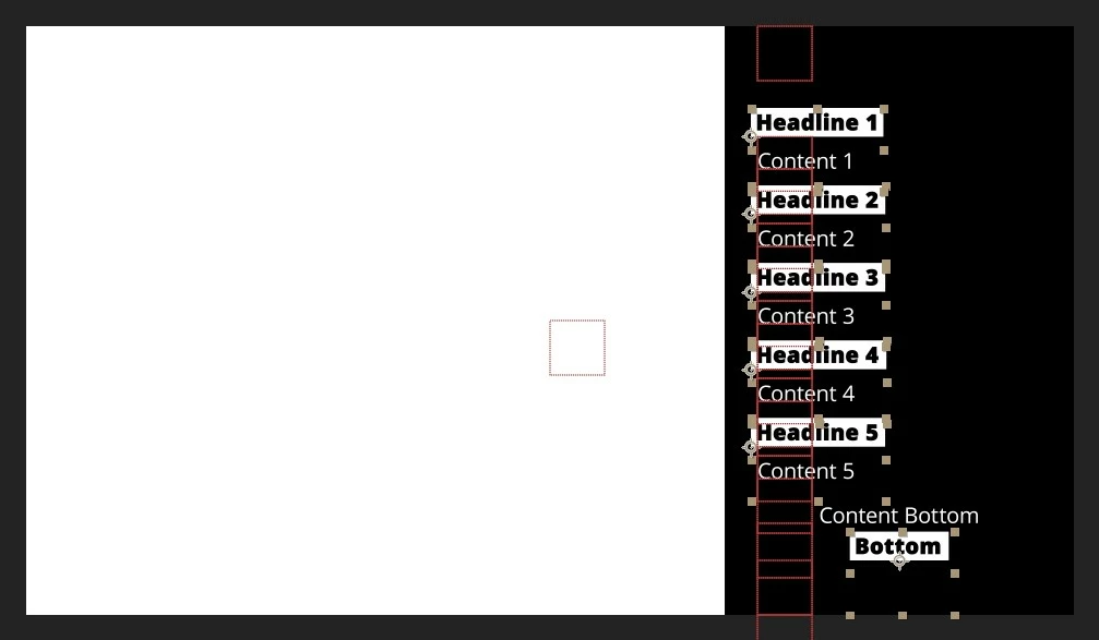

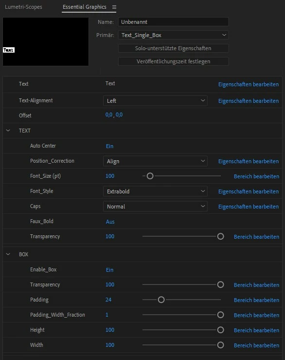

I'm currently building a modular outro for videos. I use a Subcomp with EssentialGraphic properties to get headlines with a boxed background, that resizes to the text automatically. This subcomp is as optimized as much I can do (posterizeTime(0).
Here is how it looks inclusing the properties taht are available in the headline subcomps: (It's black and white since it'll be used as a mask.)

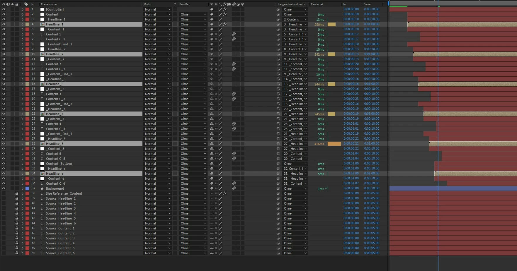

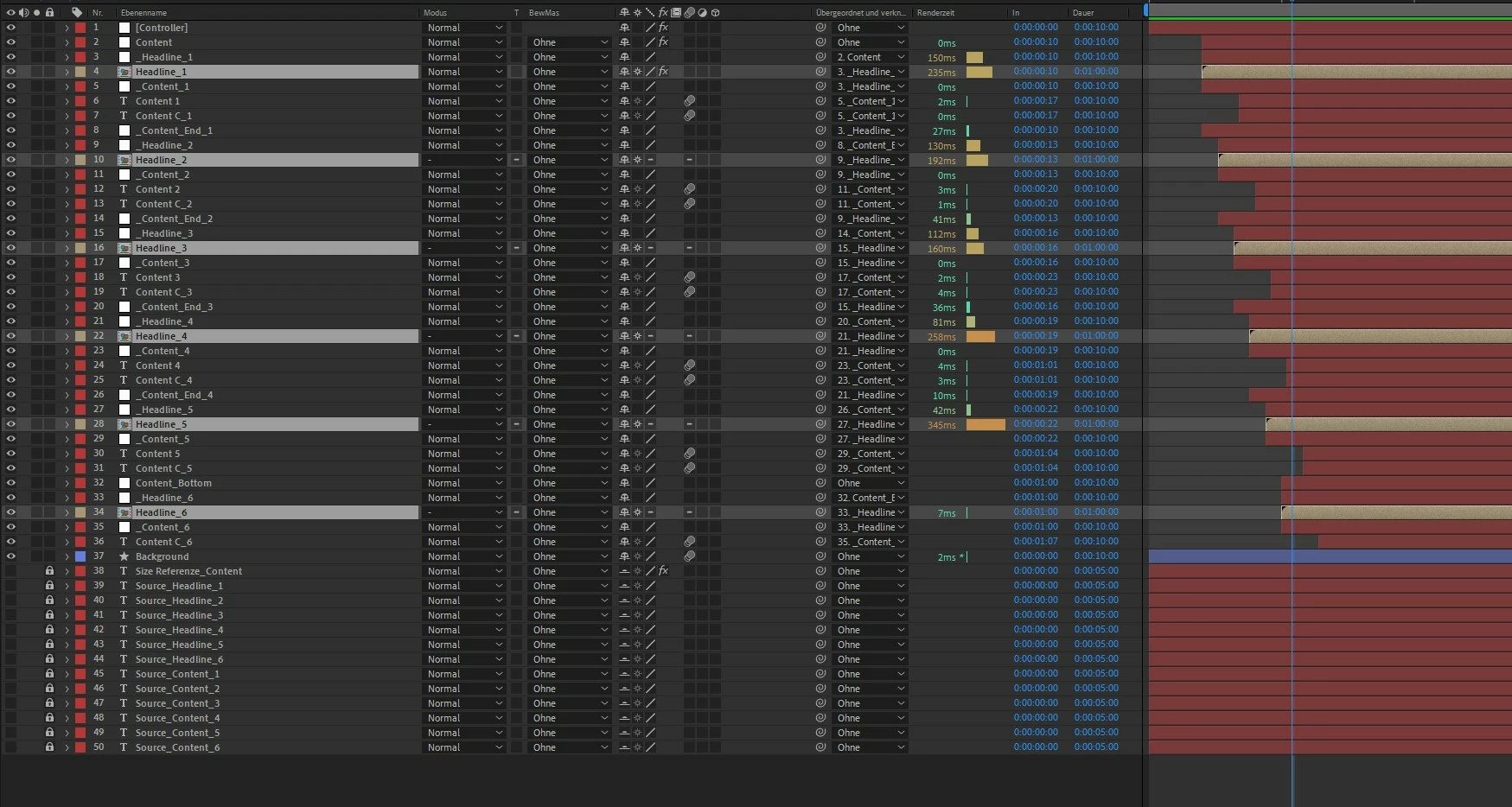

Here are two imagines of the layers and the layer render times with and without collapsed transformations:
Has anybody experienced similar things? This goes contrary to my prior believe that collapsing transforms is always slower. Is this because using EG properties make the render inherently so much slower than on the original comp? It seems like if I don't collapse the transformations the posterizeTime(0) is ignored and is thus costing some render time.
