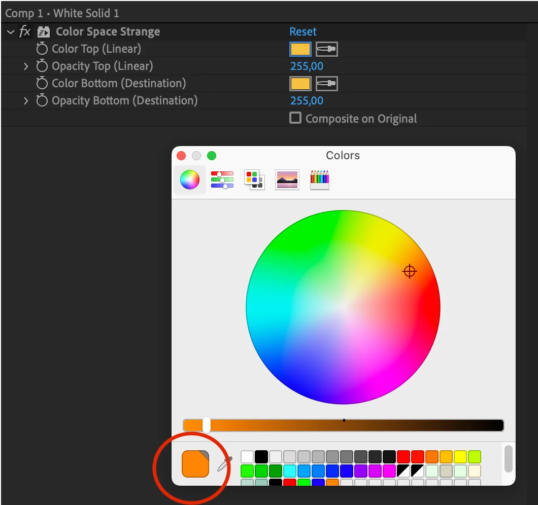

When you change any setting in the projects setting color tab,  Color Pickers of third party plugins already in the timeline are overrriden with a new color. This behavior is more obvious when changing the Linear Working Space option over a third party plugin that initialize with a default orange, cyan, or magenta color ( where RGB components are mixed to produce a secondary color). If the initialized color of the third party plugin was yellow, you now get orange.
Then if you delete the instance of the plugin and recreate it you finally get the original yellow. This is nonsense.
Going Further, on macOs, set the project to Linearize Working Color Space then change the AE Preferences to use the System Color Picker. Choose a color in the Apple Color Picker, close it,  the resulting color in the AE Color Picker is different. It is a Human interface violation.
