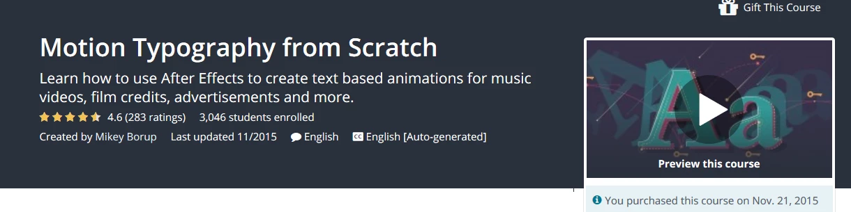

I think this was linking the text to move in line with the amplitude or "react" to its changes. The tutorial seems quite popular but i`ll see how it goes and reference the adobe training.
udemy,
