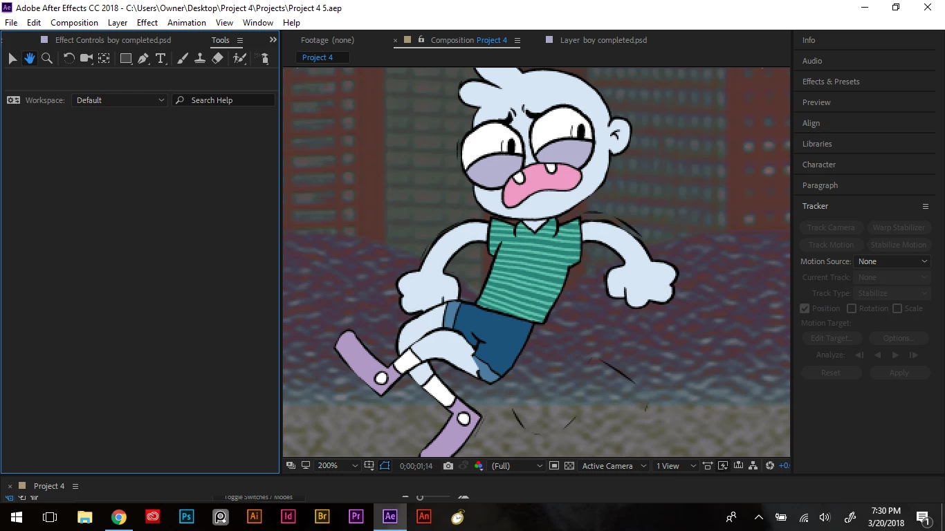

Check the mesh expansion and increase it.

This helped thank you!!!
Andrew Yoole
March 21, 2018
When you use the Puppet tool it creates "zones" in the frame that warp/distort the element that is pinned.  If you then transform the position of the puppet, the pins and associated zones fall off target.
The solution is to precompose the Puppet layers before doing other transformations.
