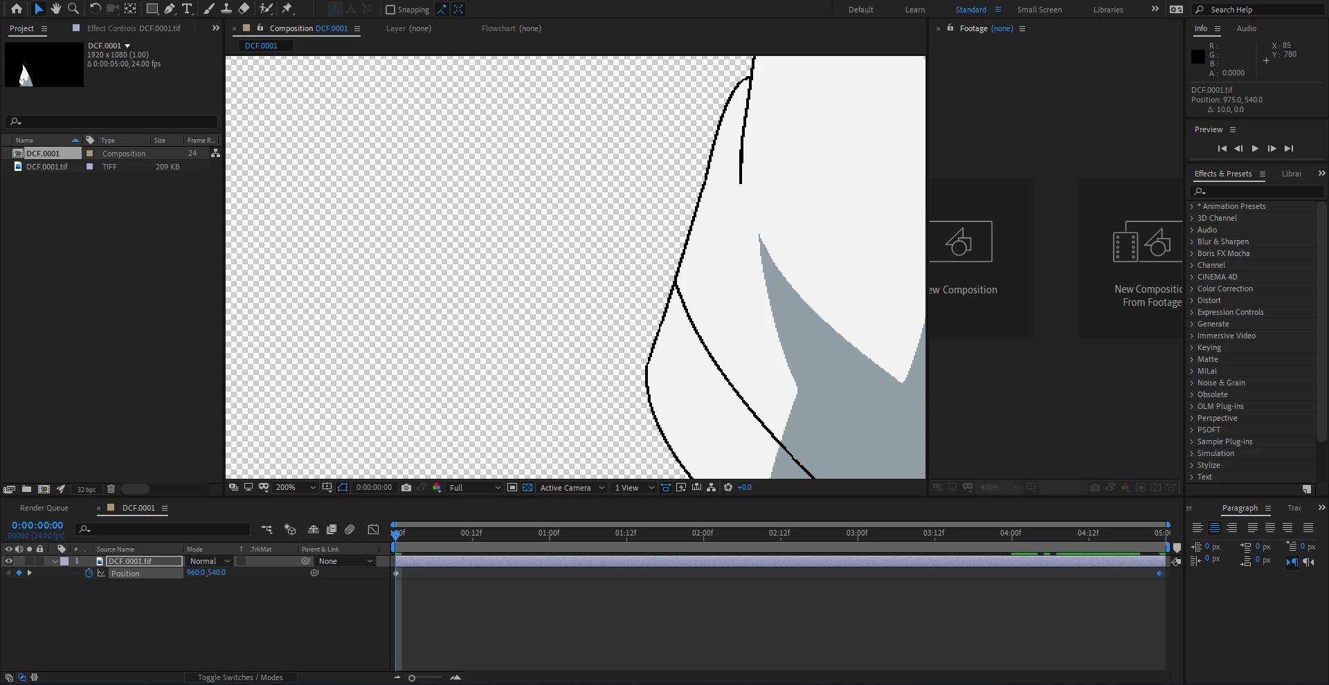

whenever i keyframe some pixelart and move it from one side to another it always blurs a little bit. I tried setting the image quality to draft, but the animation ends up being jagged or animated as if it where in 2s or 3s. is there a way to keep the pixels while the image is moving and have the movement smooth?
this has been torture trying to figure out.

EDIT: Now that I see your screenshots, you are looking at the Comp with a Magnify Ratio of 200%. You are seeing magnified pixels. Your black line is also only 1 pixel wide, so it will antialias and look more or less gray as it moves. When designing artwork for the video, the minimum recommended line thickness, especially for horizontal and vertical lines, is 2 pixels.
I would turn on motion blur and make your final quality assessment previewing the video with the Magnification Ratio set to 100%, resolution to Auto, and have the Info Panel open to make sure the preview is running in real-time.
Those thin lines, especially the black against white, will also cause problems when the video is rendered (h.264 MP4) for delivery. Color is compressed in blocks of 4 pixels, and luminance is averaged over several frames so that may cause problems getting the best quality with such thin lines.
