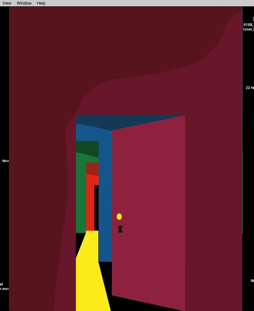

Now, both in AE but also when rendering, the curvy lines appear excessively pixelated and not sharp. Which is of course not acceptable. Continous rasterzation is turned on for every layer. I have also tried increasing the motion blur, when rendering
The dark green shadow appears in particular pixelated. This shape i edited a lot in AE - can this be the reason?
Otherwise please notice both the dark blue, dark green and yellow diagonal lines (from the light on the ground) i the quicktime frame.

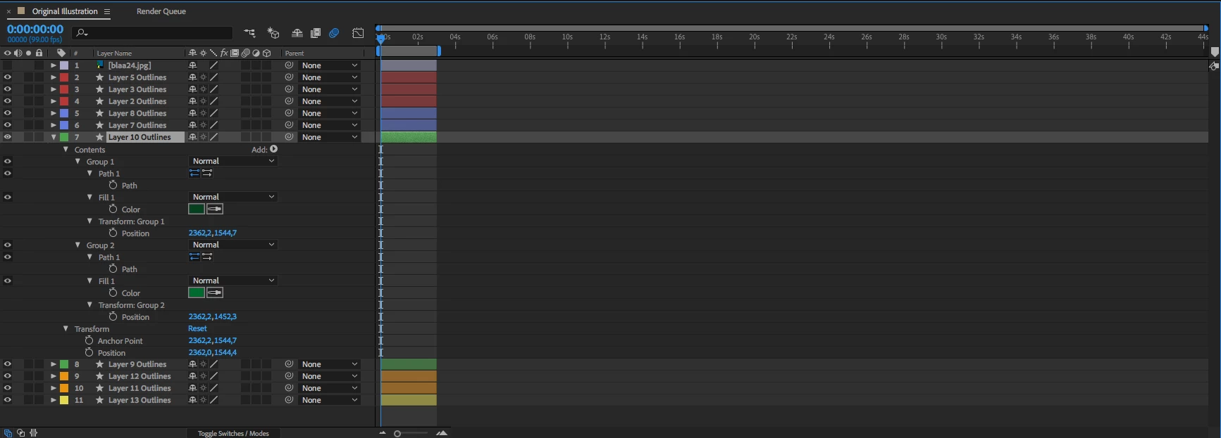

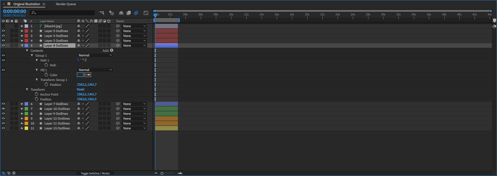

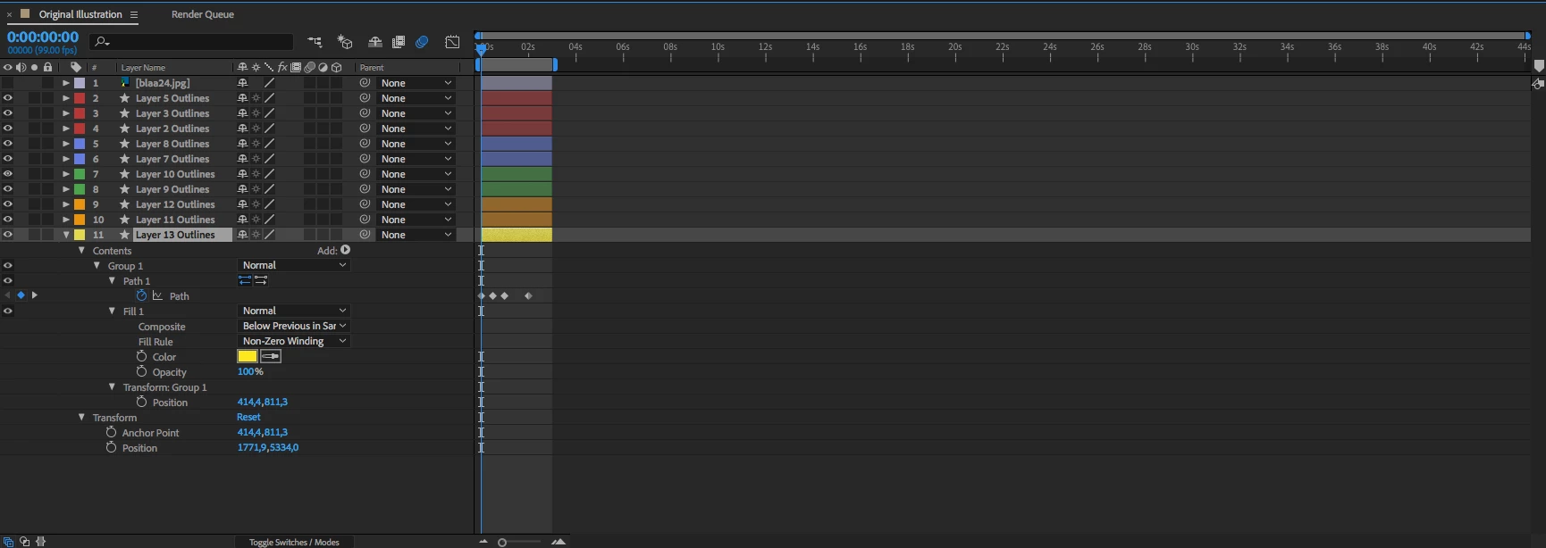

Thanks, for your quick reply. Everything is on "Normal". Here's the photos when I UU'ed dark green shadow, dark blue shadow and yellow shape

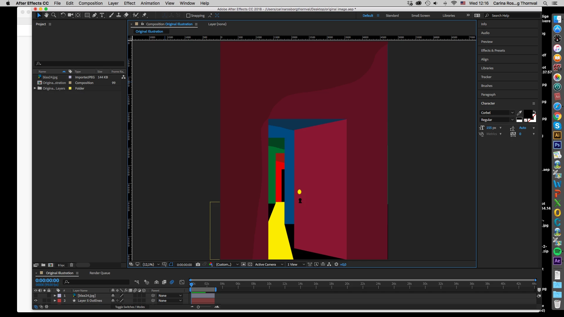

Please check the blend mode as Roei suggested and I can see that the view quality is set to custom which could be the issue. Set it to full and also view it at 100%.

This does not look like pixel issue. Check your blend mode and see it's not on "Dissolve" instead of "Normal". If that's not it then highlight the layer and press UU to see all modified properties and show it to us
