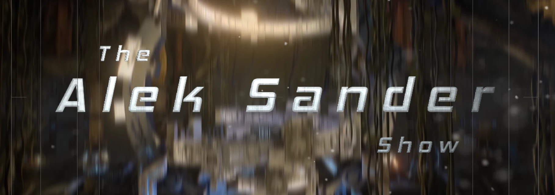

    One thing I did to resolve the issue was to set my comp settings to UHD 4K 29.97fps. My text was heavily pixelated. I followed all the steps but to no avail. Anyway, if this method helps you all its good. Im open to other suggestions.
    Perhaps creating in Illustrator then importing to AE ?  This image below is set at HDTV 1080p 29.97 fps.

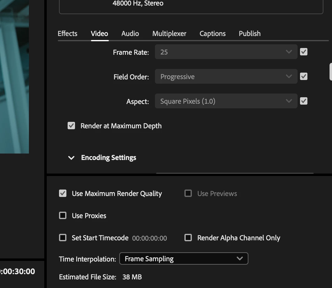

    Nothing of that worked for me. And those endless explanations are useless.
    Here is what you need to do:
    - Check the box of Render at maximum render quality
    - Check the box of Use maximum render quality

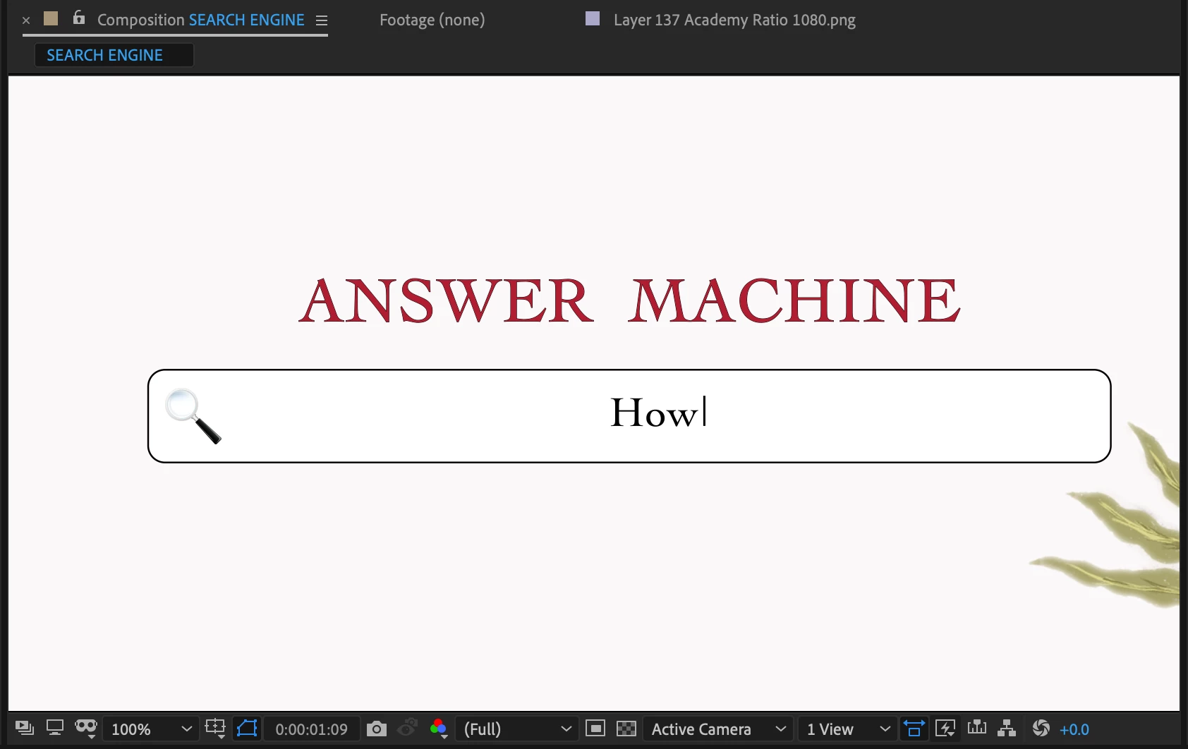

    Guy so i had a same stupid issue an i found thwe reaso try to use CTRL + SCROLL WHEEL an Than it will zoom out te comp, now you can see you font iás to small try to make it bigger in text pannel and thats it .

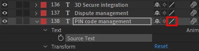

    Check out Quality and Sampling is set on

    This is the only answer. I cannot believe the cascade of BS this request elicited. If your outline text (or any text) looks chunky or pixellated, especially on curves, you have the text layer set to "Draft" and need to click the little box.
