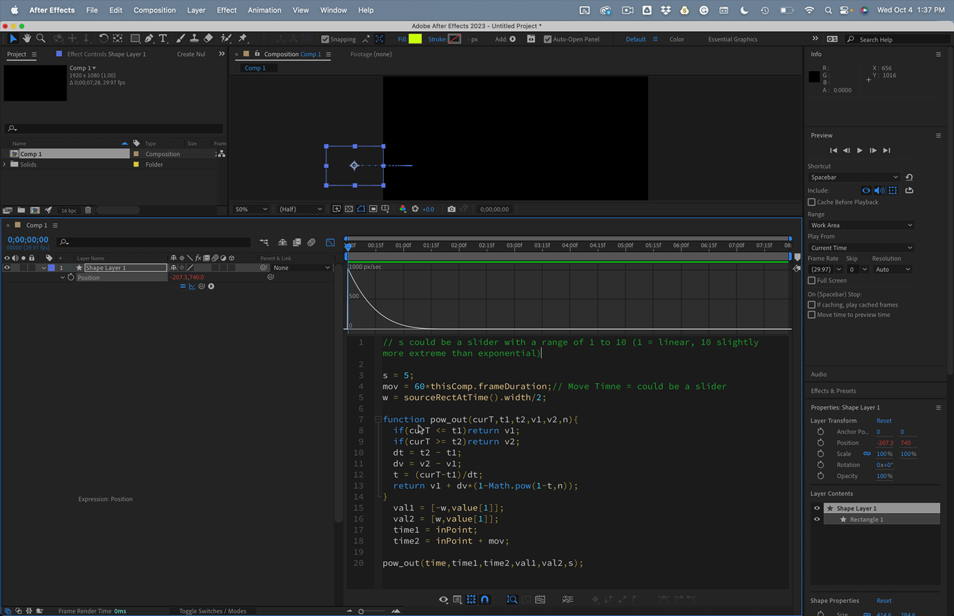

The expression to adjust the deceleration speed of the move gets a little more complicated. Something like this would work:
// s could be a slider with a range of 1 to 10 (1 = linear, 10 slightly more extreme than exponential)
s = 5;
mov = 60*thisComp.frameDuration;// Move Timne = could be a slider
w = sourceRectAtTime().width/2;
function pow_out(curT,t1,t2,v1,v2,n){
  if(curT <= t1)return v1;
  if(curT >= t2)return v2;
  dt = t2 - t1;
  dv = v2 - v1;
  t = (curT-t1)/dt;
  return v1 + dv*(1-Math.pow(1-t,n));
  val1 = [-w,value[1]];
  val2 = [w,value[1]];
  time1 = inPoint;
  time2 = inPoint + mov;
pow_out(time,time1,time2,val1,val2,s);
I have an animation preset that uses sliders for "s" and "mov" and includes a bunch of other options.
You can use a simple pickwhip expression to tie the position of your text layer to the position of the Shape Layer Background. It all depends on how you position the text layer, and it may depend on how you generate the shape layer background size. I'd have to see your timeline with all the modified properties of the text layer and the shape layer background revealed. Just select the layers and press 'uu' to show them all. If you have any expressions, share them as well.
Here's the expression in action with the Graph Editor showing the change in the speed as I change the s value:
I hope this helps.
