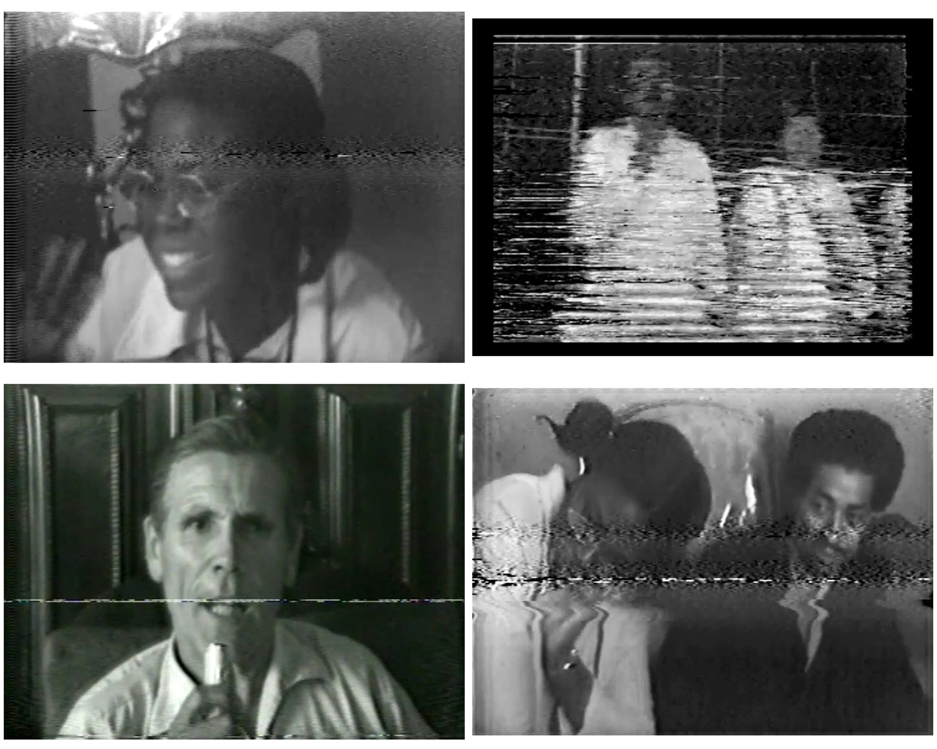

The digitized transferred 8mm film I am working on is black & white.
There is work to do to fix this material for potential upload to YouTube.
The owner of the film said to fix the 'banding' I would need to work with his suggested method. I do not know how to do that.

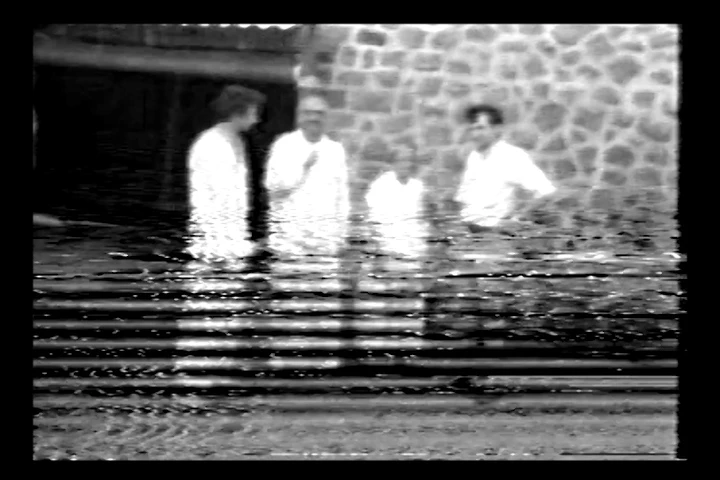

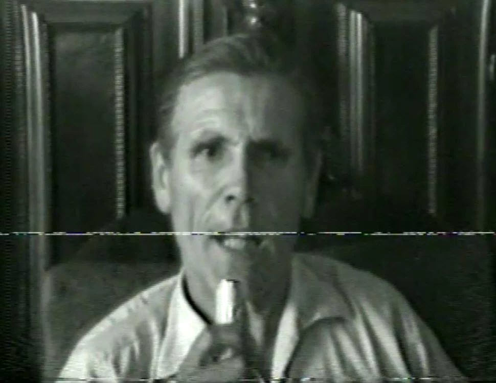

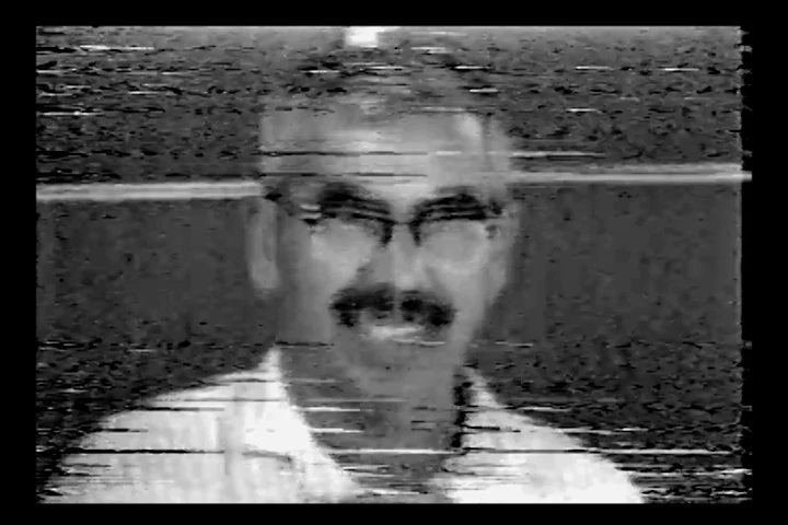

I have attached captures from several films to show the intrusive artifact, white streaming streaking lines. I goggled 'banding, horizontal lines' and so forth. I could find no description of what those lines are named.
To work on the film especially those lines I need to know what they are named. Then I could research how to possibly make corrections.
The film may be 20 minutes however the lines flutter in and out here and there leaving most of the film viewable.
What exactly is I dealing with and is there a method to fix these aberrations.
The owner said his methods works - I don't know how to do that.
Let me know if you can help with this difficulty.
Thanks!

Those problems occur when you don't use the proper equipment to make digital copies of motion picture films. Equipment ranges from a variable speed projector projecting on a screen that is being shot with a cheap digital camera or a smartphone to true film scanning equipment. The latter is expensive, but it will provide an accurate copy of every original frame and you can either request raw copies or color corrected and enhanced copies.
I agree with Mylenium. The repair process for that kind of problem is not easily automated and it requires a lot of time.
The artifacts look like errors from damaged videotape or clogged heads on the machine that was used to digitize the footage.  They don't look at all like damaged film. I've worked extensively with historical footage for several documentaries and transferred more than a couple hundred hours of old footage to videotape. None of the problem frames look like damaged film.
Starting at the top right frames 2, 5, 6, 8, 9 10, 11, and 13 have very little chance of being repaired with any kind of automated formula. You would need a digital artist to repaint those frames by hand.
In the late 90's I was involved with an extensive 2" (Quad) videotape restoration and conversion to HD project for another documentary and those artifacts look very familiar.  If the original footage is still available it is going to be a lot better to just send it out to a proper professional facility that can actually scan the frames and deliver a lossless digital master.  If all you have to work with are these corrupted video files it's going to take a very long time.

Mylenium
June 26, 2021
That looks more like a serious film restoration job and just averaging the lines sounds like a terrible idea since you're throwing away more of the already sparse actual information due to the blurriness and other artifacts. As far as I'm concerned This would require a much more meticulous approach where you actually sample lines from retimed duplicates, mask stuff out, use clone stamps, reconstruct shapes with masks and so on to using semi-automated functions like adaptive blurs and of course Content Aware Fill et al.
