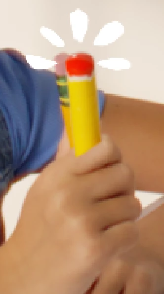

For what it's worth I've attached two images of the problem. What you are seeing is comp A, with and without the posterize time effect enabled. The pencils should not be separated from eachother.
