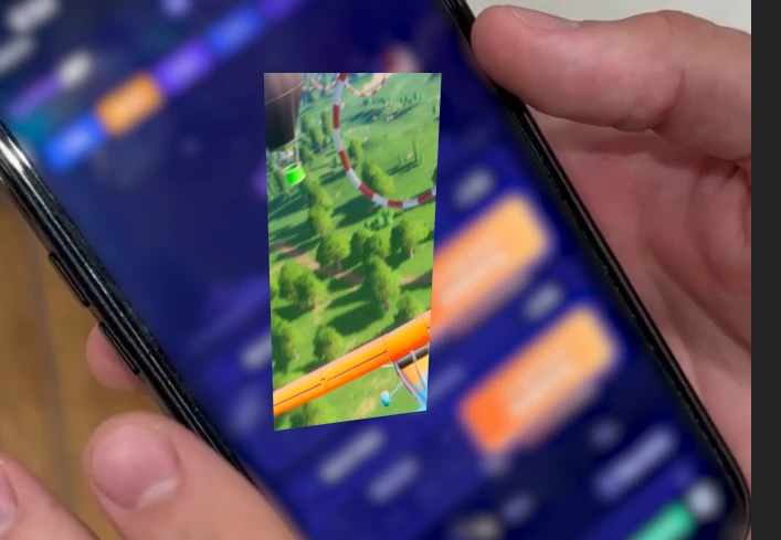

Precomp become low-res
In my pre-composition, the quality of the picture is very lost. I added a track from mocha pro for screen, but I don't think that's the problem. when I collected these files and transferred them to another project, everything is fine there. When I Continously Rasterize, the picture becomes of normal quality, but becomes irregularly shaped. I add image and video.

I am not sure what is going on. Check to make sure that the main comp and the Green Solid 1 Comp 1 are the same size. Layer 4, the Green Solid, is turned off, and there are effects applied, but it isn't doing anything, so it should be deleted. Layer 5, the Adjustment layer, has nothing below it, but effects are applied, and that could be causing the Collapse Transformations problem. You should delete or move that layer up so the effects are applied.
