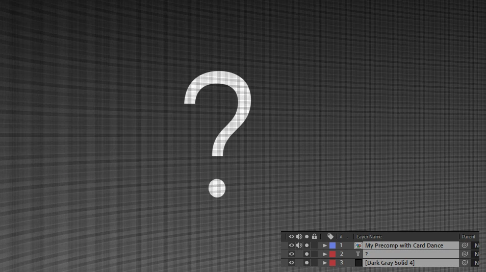

I have a Pre-compose with bunch of Adjustment Layers inside. I'm using this precomp as a copy-able predefined effect - placing it on timeline and turning on the collapse transformation option. Every single effect that I used worked so far - until now.

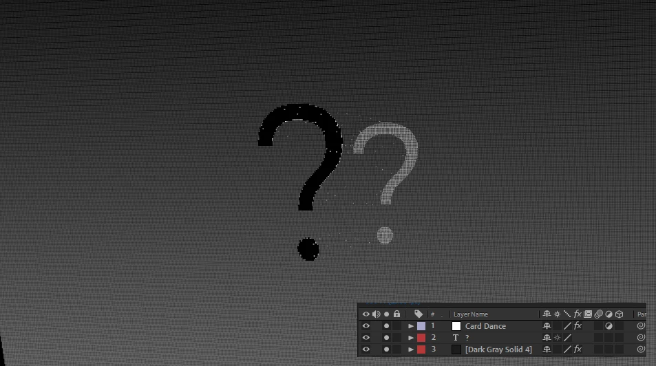

Card Dance is on the first Adjustment Layer - if I place anything inside the precomp, under Card Dance - it works correctly, if I try to use my precomp with collapse transformation - it gives me wrong result. Take a look :
1. Precomp with Collapse Transformation enabled - wrong result
2. Precomp inside (I copied the "?" and Dark Gray Solid layers) - correct result
What do you think? Is there anything I can do?
Correct answer Mylenium
There's nothing wrong. 3D effects like card dance don't respond to collapsed transformations. This has nothing to do with how it works for layers. 3D effects are a complitely separate universe inside their own bubble. you have to think of something else and restructure your project.
