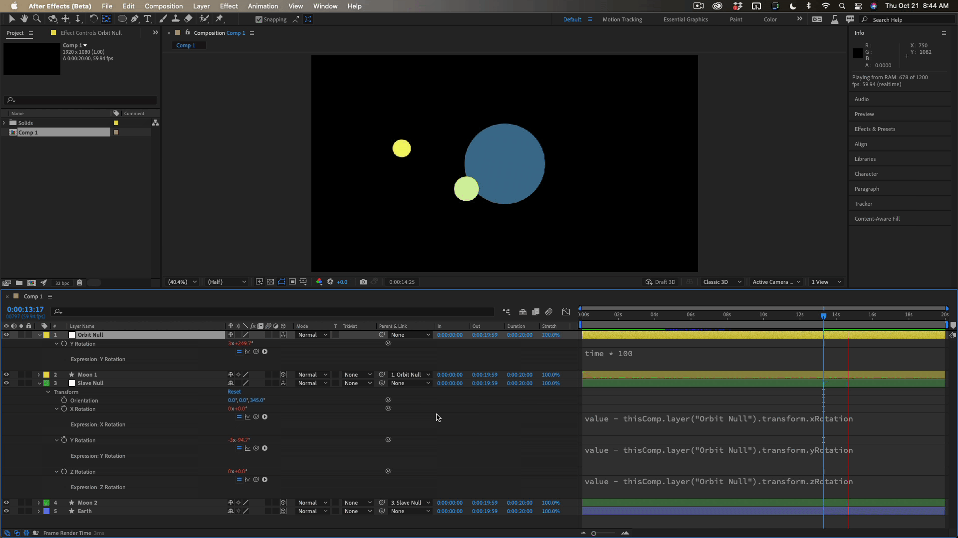

The basic workflow is flawed. I would use two nulls, tie the X, Y, and Z rotation of the slave null to the rotation null with an expression. Here's the expression for Y rotation on the Slave null:
value - thisComp.layer("Orbit Null").transform.yRotation
 Then all you have to do is arrange your comp like this:
It is going to be a lot easier to adjust both the position and orientation of each orbit. The trick is changing the orientation of the Slave null.
The problem using a duplicate pre-comp is that the 3D space for the nested comps and the animation is going to be identical when you turn on collapse transformations. You are way overcomplicating the problem.
I've uploaded my comp for you to take a look at. Took me all of 10 minutes to set it up.

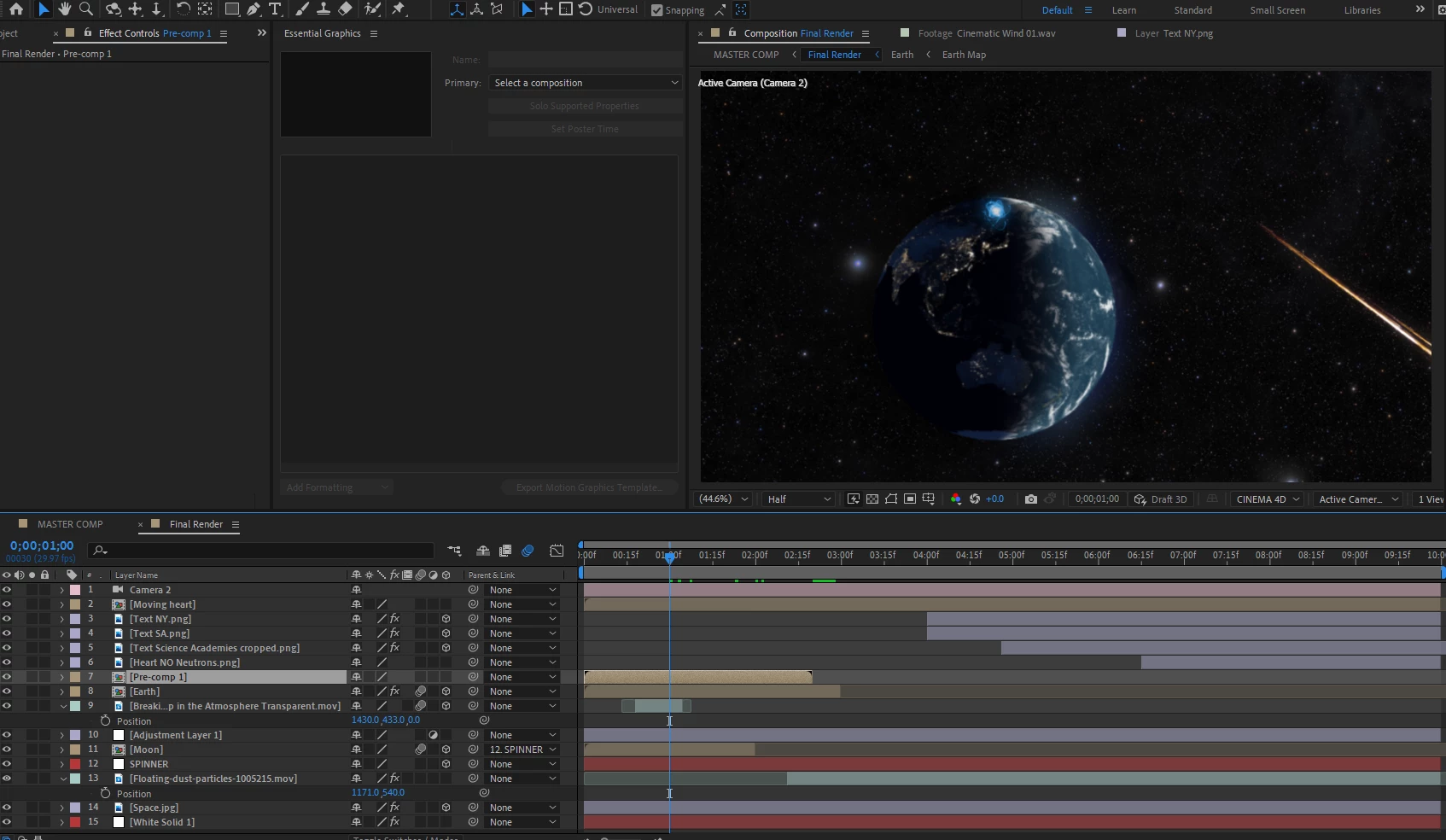

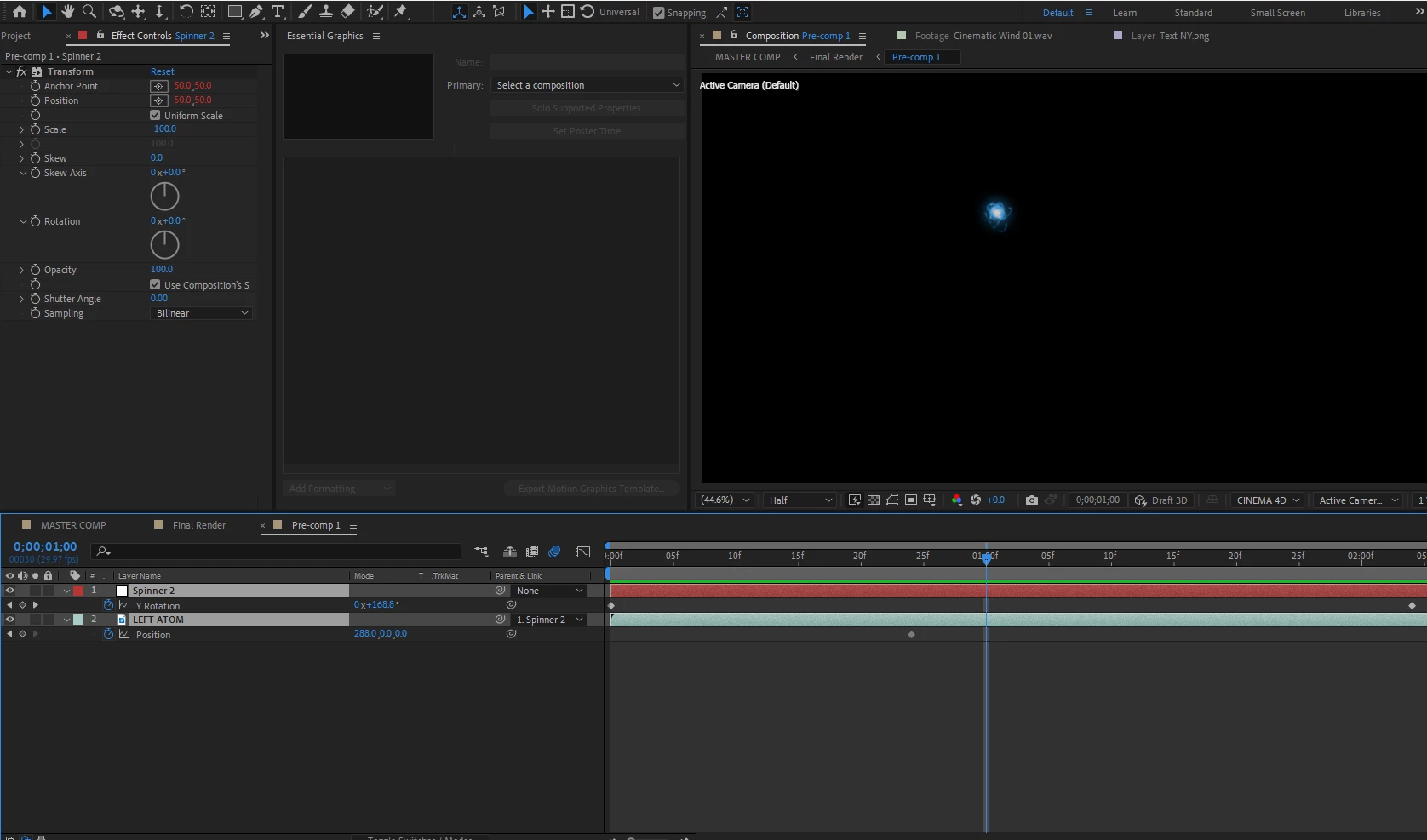

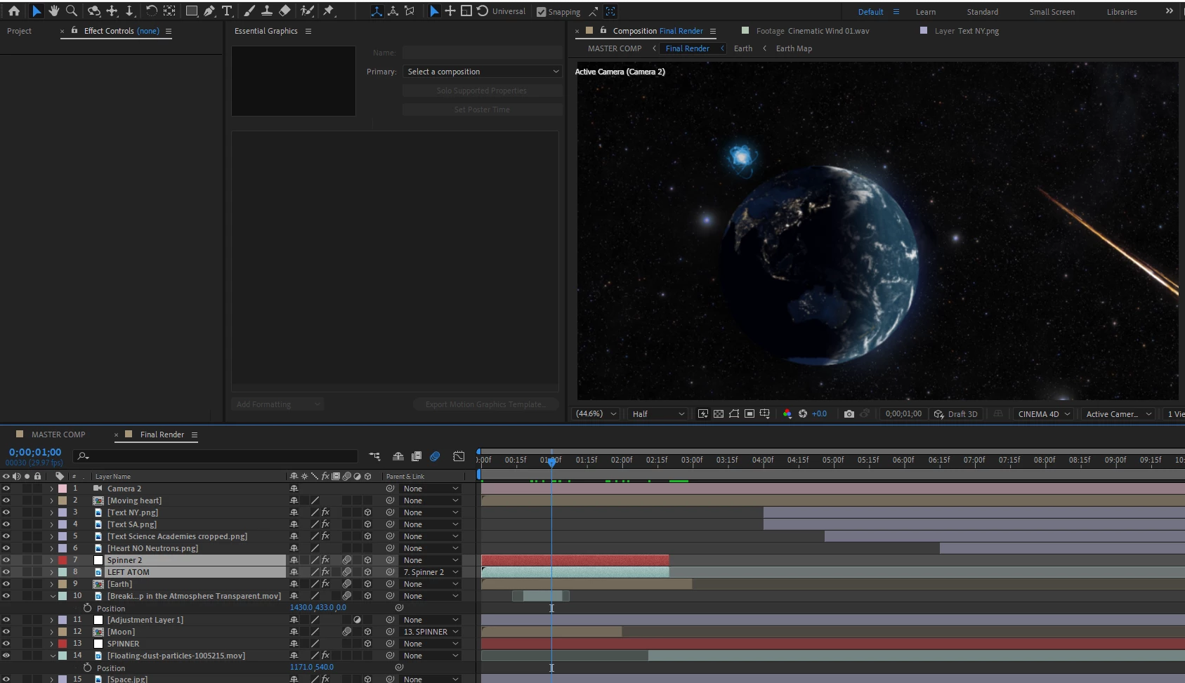

It sounds like it made sense to me but I tried creating the precomp with tranformations collapsed and it still happens. I'm attaching screen shots that should be linear order of my operations. The second screenshot is the same frame so you can see the difference in position.
