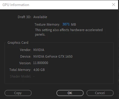

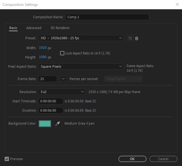

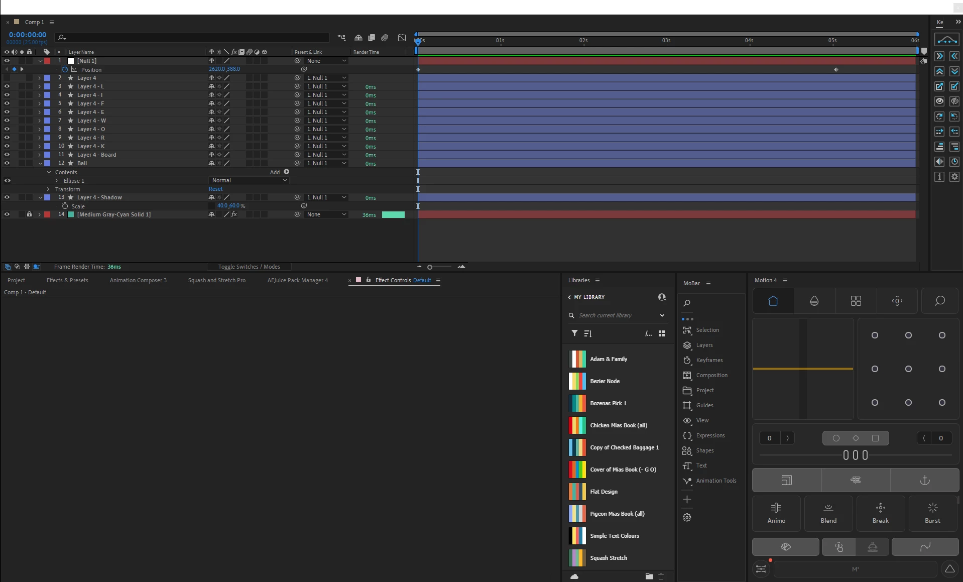

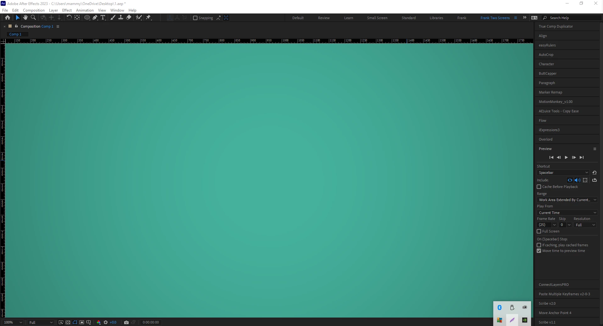

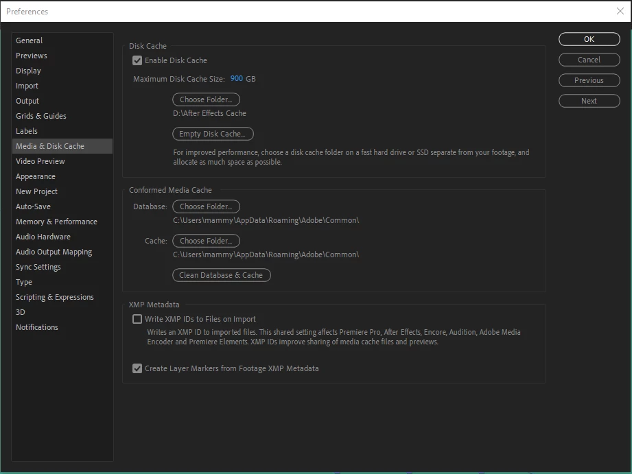

I updated AE to the new 2023 version and it has been fine so far but suddenly everything is blurry. Even simple shapes are stuttering and glitching in the AE preview. I have attached a few screenshots of settings and a quick rendered video through Media Encoder but as I say the problem is within AE as the video shared actually looks worse in AE itself.

The C4D renderer has nothing to do with Cineware/C4D Lite. It's always available in the advanced composition settings. If that isn't the problem then you really need to tip-toe through all settings that could affect framerates - comp settings, project settings, preview settings, footage interpretation, render settings.

Your stuttering could indicate framerate mismatches, so check the comp settings, preview settings, footage interpretation. The rest makes no sense. What is a big pale green solid supposed to tell us? If there is any bluriness, you need to choose a suitable example with actual visible edges. That, ansd of course you haven't provided any system inffo, details about your hardware acceleration settings, cache settings and so on. You need to provide much better and more info.

The big green solid in the screenshot should have been minimized; the preview settings were to the right of it and I wanted to just share my whole screen in case there was something that I was unaware of given my level.

External Hard Drive for Cache:

The GPU is NVIDIA GeForce GTYX 1650 and I’m set to Mercury GPU Acceleration (CUDA) in project settings.
There doesn’t seem to be any discrepancy in frame rates. Everything is set to 25fps. I’m not importing any video footage. Everything is created in either Illustrator or AE itself although this problem did start when I imported a vector file from Illustrator (via Overlord). What was done earlier in the project seems to play fine as do previous project files when I open them whereas anything I create now has this migraine-inducing blur to it.
I uninstalled and reinstalled AE 2023 and even installed 22.6 again but the same result in both versions. I don’t think it has anything to do with screen display settings as previous work looks fine. I only see this when I’m previewing and in what I render, when things are still they’re crystal clear.
