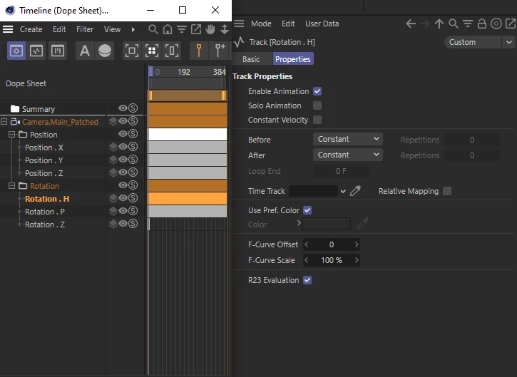

I discovered a checkbox called "R23 Evaluation" This resolved my issue. I'm using r25 currently.
