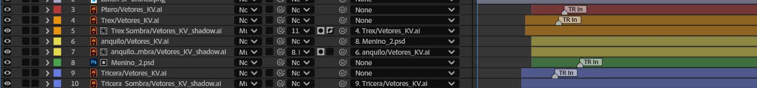

Hello! I created a project using layers from illustrator as I have done multiple times before. In After Effects everything seems to be in the right place, but when I send to Media Encoder to export, the sahdow layers change position and get clipped. Is there a setting i need to change when exporting that may be causing this? I've tried multiple presets and it looks like this with any of them.
Layers:
On After effects:
