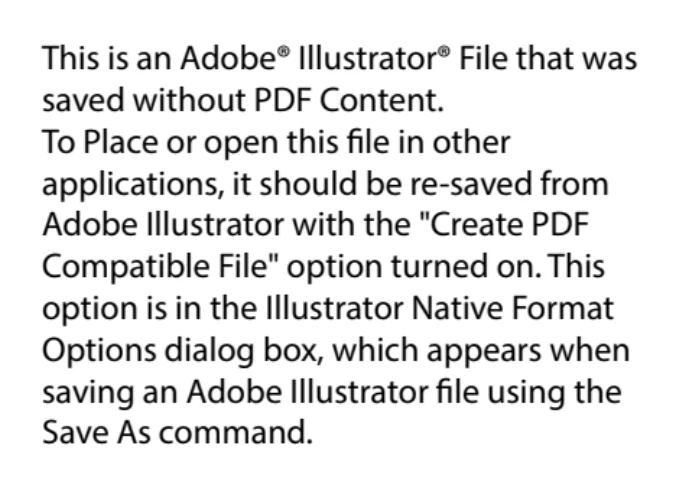

problem went i import a illustrator file to after effects
  • May 19, 2018
  • 8071 views

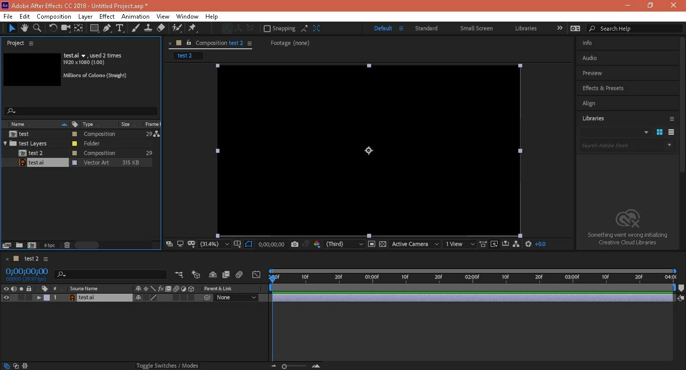

the problem is when importing an .ai file to after effects this is not shown correctly, I get text or black screen, just open me .eps but I can not do anything, i try to reinstalling after effects and illustrator and nothing , I have the updated drivers and try creating a new file after reinstalling Illustrator but it only showed me everything in black even though text was no longer available, someone knows how to solve this error, thanks
Correct answer Rick Gerard
i save you file with my illustrator and now don't work in after effects - this is your file that i save with my illustrator
this is you file that save
and this is you file

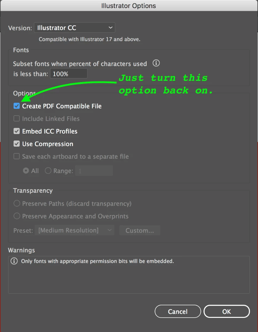

Dropbox says it all:
When you save a file this dialogue should pop up.
That should fix the problem.

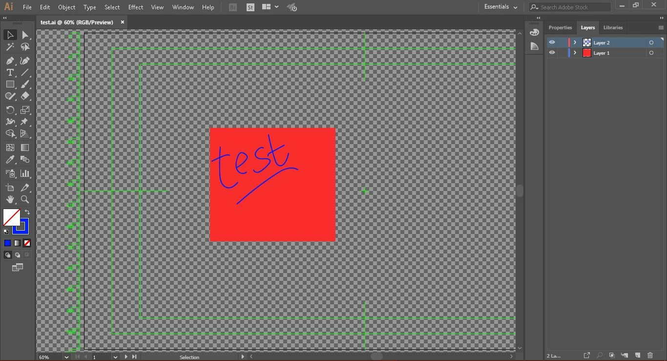

Try this.
Start a new AI document 1920 points by 1080 points. Select any of the shape like the Rectangle tool and draw a shape with a red fil and no stroke. Add a new layer in the layer panel. Use the pen tool to draw a line with a blue stroke about 10 points wide in the second layer. Save the AI file and then import as a composition with cropped layers in AE. You should get a comp with a red shape on the bottom layer and a blue line on the top layer. The background would be black. If that works then the problem is with your original file.

i follow you instrutions but
I went back to re-install again illustrator and later i create the new document with you instrutions but nothing happen U_U
this problem it only happens with the .ai files but no with .psd

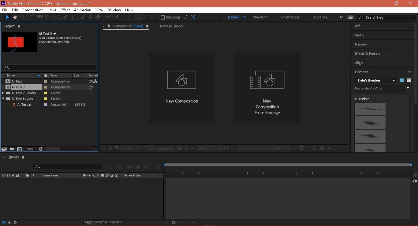

Try this file:
Dropbox - AI Test.ai
