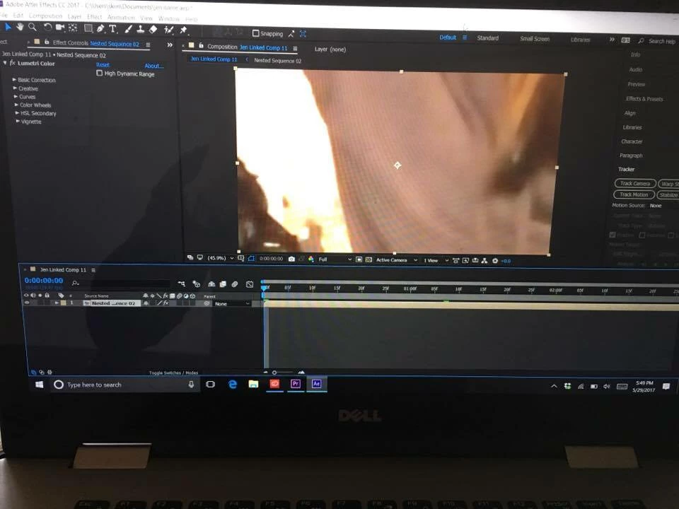

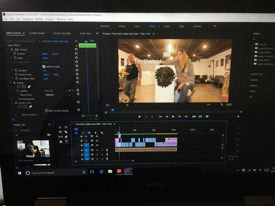

    May 29, 2017
    So the 1st pic is in pro and the 2nd pic is what it scales to in after.

    interesting. in premiere you have a nested sequence, what is inside it? do you have any premiere effect's applied inside the nested sequence? something probably is getting lost in the translation to Ae.
    I can't reproduce this problem. try to isolate this problem and reproduce it in a fresh sequence and then tell us the steps to recreate it.
