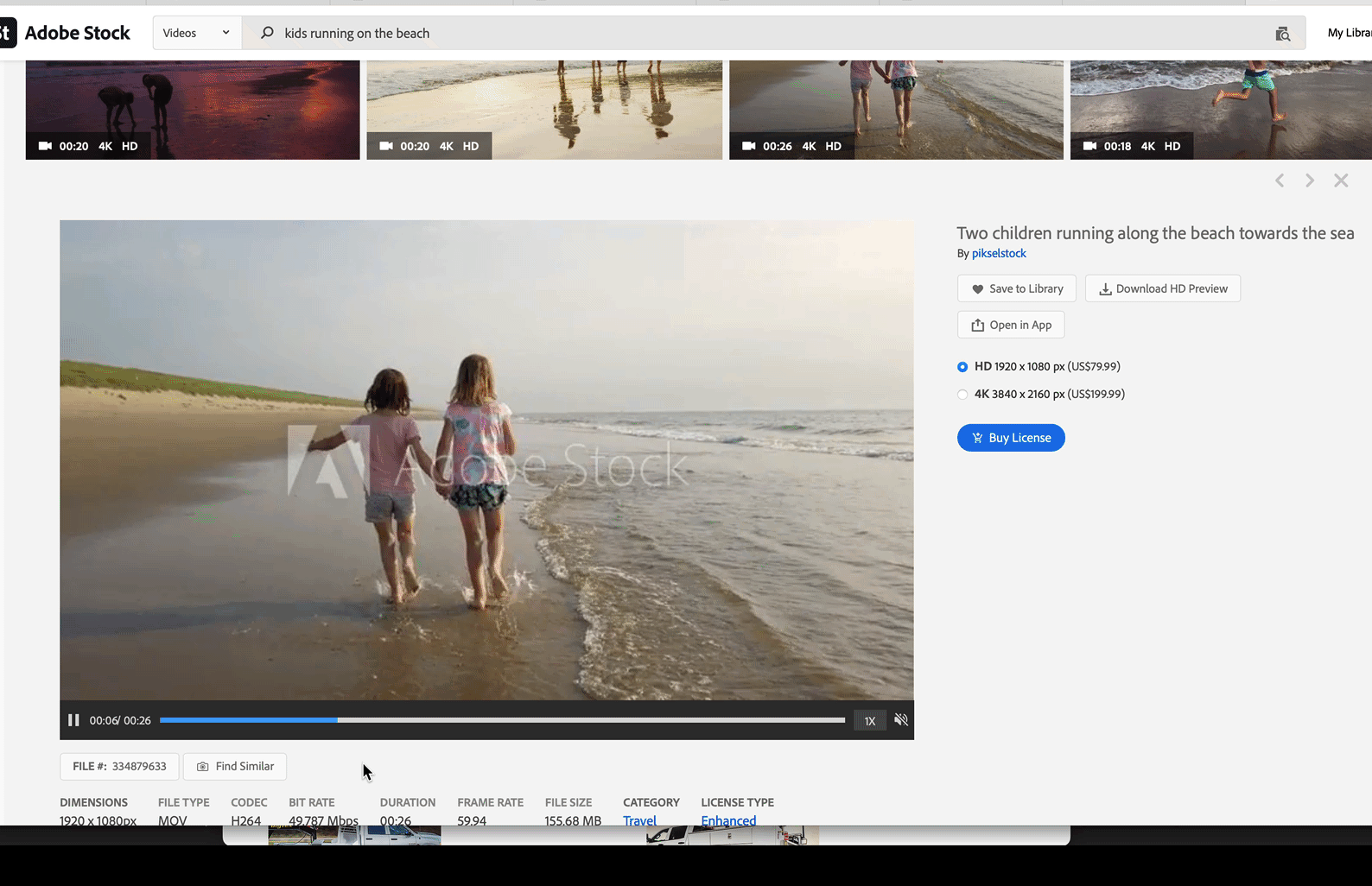

This shot would be nearly impossible to track:
It might camera-solve, but the moving water, lack of detail in the sand, and the reflections would foul up any tracking data and make the camera track useless.
