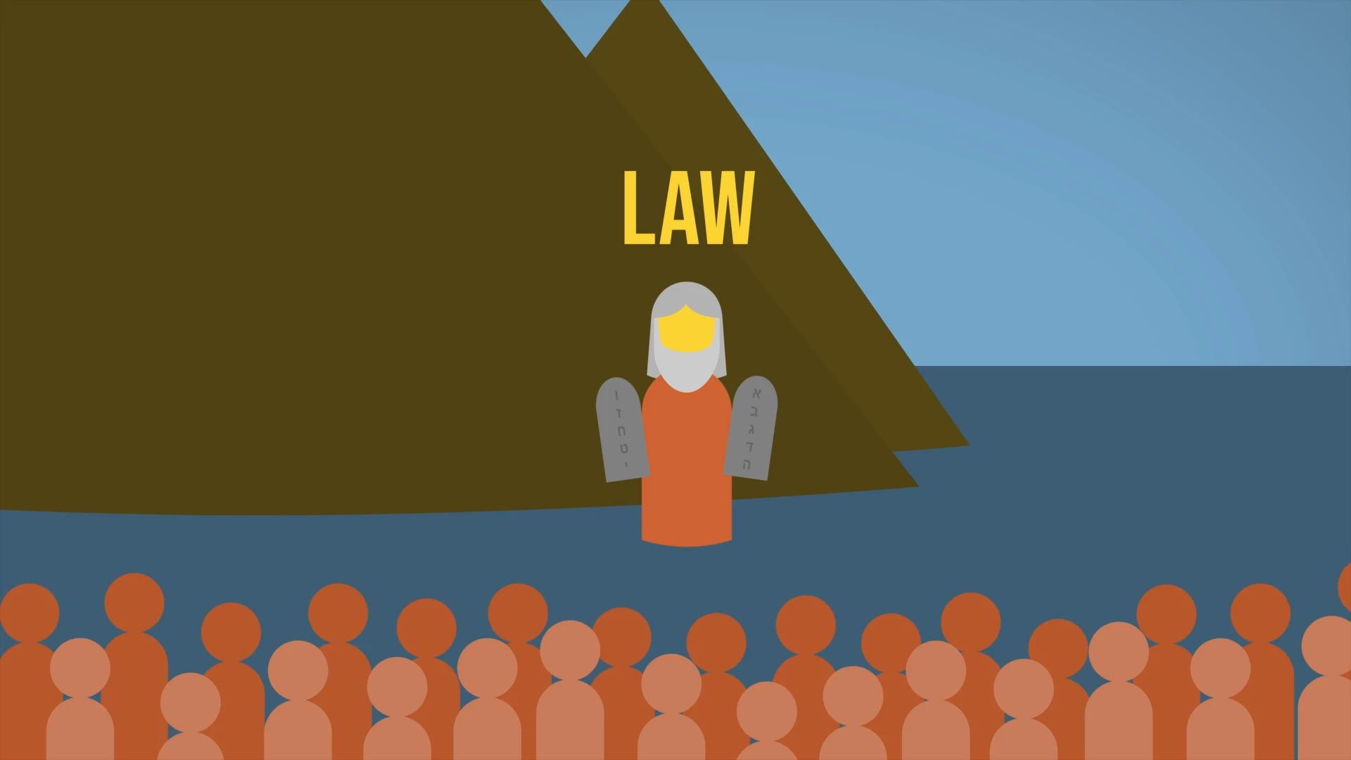

This is a screenshot from playing back the original export on my computer:

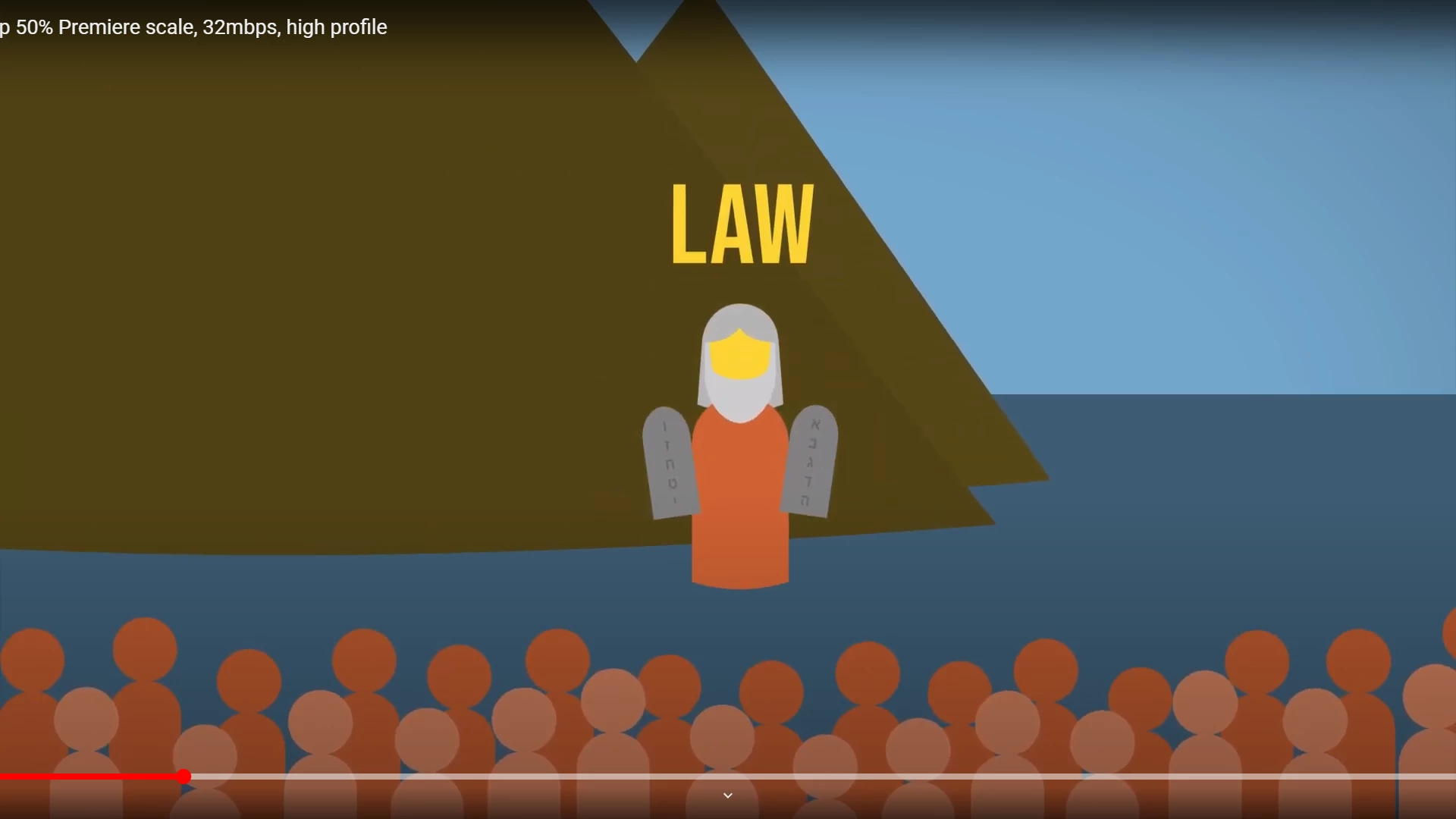

And this is a screenshot from the YouTube upload itself.
The YouTube version is way grainier around all the edges, and the edge between the two mountains is particularly bad.

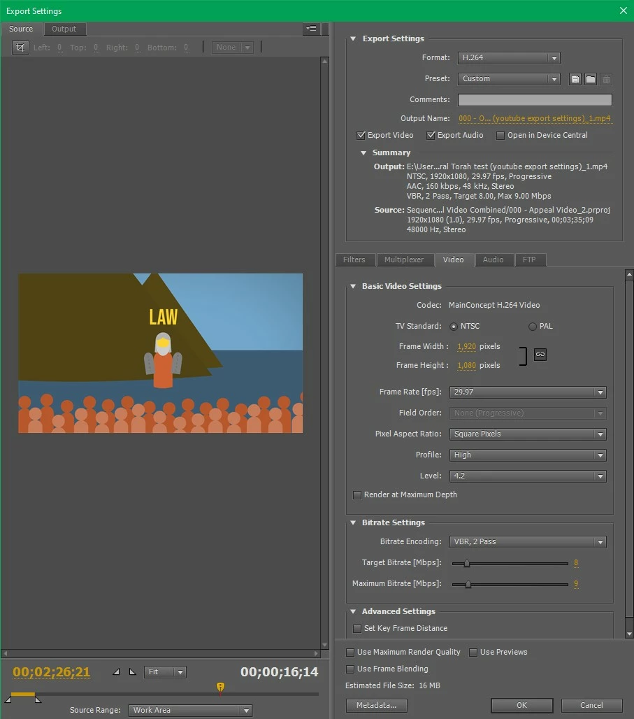

I've tried various export settings, I've tried making the animation 50% scale in AfterEffects (before bringing it into Premiere), I've tried making it 50% in Premiere, and everything I've tried has ended up looking the same. I'm using Adobe CS5.5, so the only export settings in Media Encoder that are labeled for YouTube are 720p or smaller. This was my most recent attempt to mess with export settings and get something that looks good (though I've also tried it with Widescreen pixel aspect ratio, and with higher bitrates).

My first suggestion would be to use Adobe Media Encoder's YouTube presets. You have completely customized the compression settings. YouTube and all other streaming services and social media platforms have recommended that compression, frame size, and frame rate standards be adhered to. Upload a file that does not come close to the standards, and they will recompress the file with a sledgehammer. You have set the target bit rate to half the recommended bit rate for YouTube HD renders, so you have cut the quality in half before YouTube even gets the file. Use the presets until you have an expert understanding of video formats and standards. You'll get great results on almost all of your videos. The ones that need tweaking will be videos with color balance, contrast, and audio levels that are way out of spec.

I have an old version of Media Encoder (CS5.5, as I said in the original post), so the YouTube presets are all 720p and lower. That's why the bitrate and such are so low, is because our latest attempt was trying to take the YouTube 720p preset and adjust it for 1080p. But I've also tried other exports with bitrates of 10mbps, 15mbps, and even 32mbps, just using default HDTV settings. Nothing has worked.
