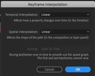

Some one in that thread already tried to help me, saying that I should look if the keyframes were linear, they were.

Andrew Yoole
December 8, 2019
Right click the keyframe where the move begins, choose "Keyframe Interpolation" and make sure Spatial Interpolation is set to "Linear".
Temporal Interpolation affects the way your object moves over time.  Does it start slowly and speed up, or does it instantly move at full speed?
Spatial Interpolation affects WHERE the object moves in space.  Does it travel in a perfectly straight line, or does it follow a curve?
December 8, 2019
But I stated in my post that I had already tried that and it did not work.
