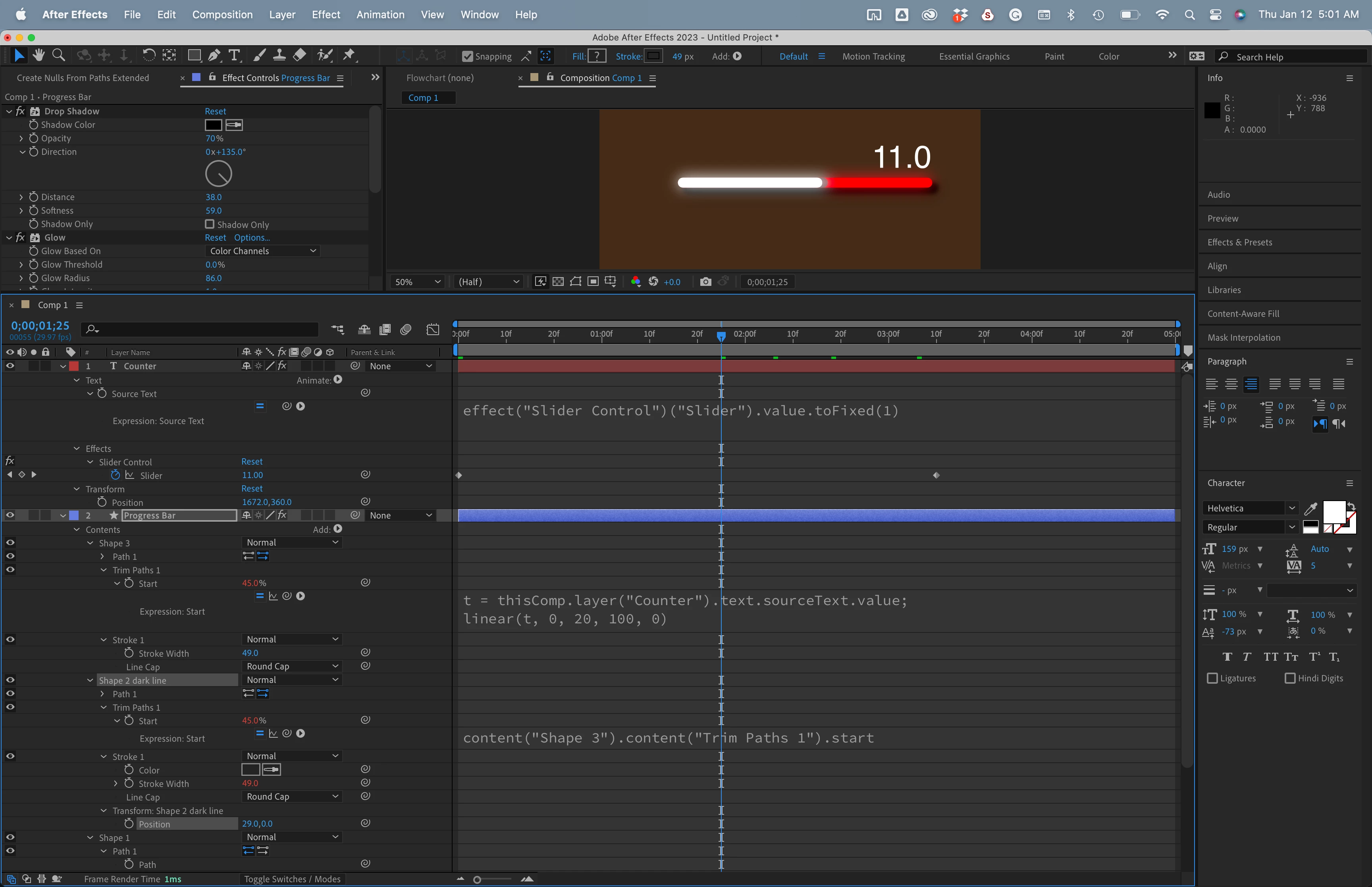

This is how I would do that:
All of the appropriate properties have been tied together with simple expressions.
I've shared the project file.
