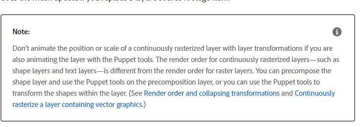

Puppet and shape layers don't mix well. shape layer are always turned on for continuously rasterize and this means that transform is applied before the effect instead of after. so it's as if you are moving a layer within a mesh that was set in the initial state. first you transform, then the effect is applied. get it? the effect is fixed, but the layer is moving from within it. then it breaks really.
if you want to use puppet effect on a layer, you should make sure it's not continously rasterized (or collapsed) basically make sure the sunburst switch is off:
you can read about this issue: Animating with Puppet tools in After Effects
