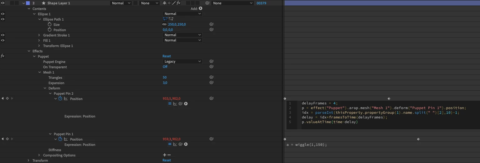

I have a circle with two puppet pin points, ppp1 at the bottom and ppp2 at the top.
What I want is ppp2 to follow ppp1 with a delay, but only in the x axis.
I found this:
delayFrames = 4;
p = effect("Puppet").arap.mesh("Mesh 1").deform("Puppet Pin 1").position;
idx = parseInt(thisProperty.propertyGroup(1).name.split(" ")[2],10)-1;
delay = idx*framesToTime(delayFrames);
p.valueAtTime(time-delay)
And it works but with the x and y, and I want it only to follow the x, maintaining the y the same.
How can I do this?
Thanks in advance!
Correct answer Dan Ebberts
Try changing the last line to this:
[p.valueAtTime(time-delay)[0],value[1]]
Dan Ebberts
Dan EbbertsCommunity ExpertCorrect answer
March 5, 2022
gonpleonAuthor
March 8, 2022
It works! thanks a lot.
