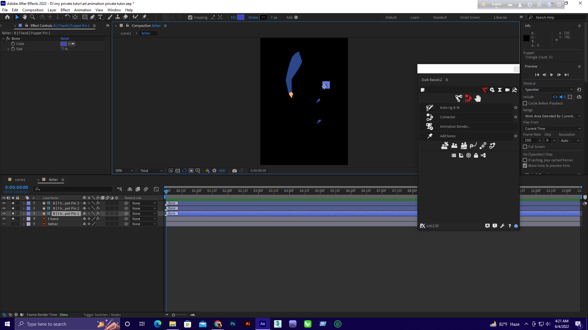

when add bones didn't add on specific object in after effects.how can i fix it?

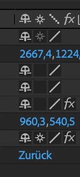

Hello I had the same problem as you, turned out I had to disable the "Continuously Rasterize on vector layers"
(The box in the middle) because the puppet pin tool doesn't work with it sadly.

This works for me!! Thanks
