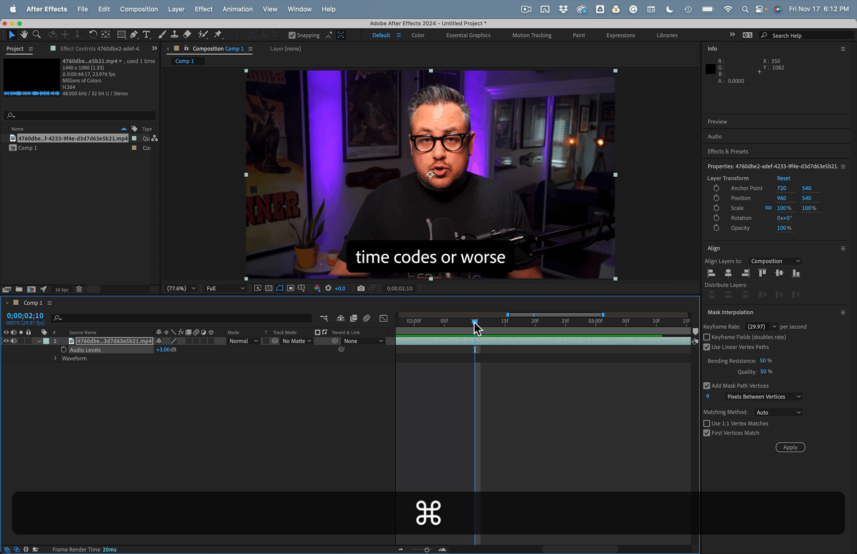

Hold down the Ctrl/Cmnd key, click on the CTI, and drag it one frame at a time to hear the start of a sound. If you drag one frame, it will play the sound from that frame. Drag it along slowly, and you'll hear a choppy sound. If you hold down the Ctrl/Cmnd key and click and hold on the CTI, you'll get a looping preview about one second long. It's an easy way to find the start of a word.
You can press the L key twice with a layer selected to reveal the Waveform, then drag it down to make it as big as you need to see what's going on visually. Hold down the Shift key and press the L key again, and you'll also get the Audio Levels parameter. You can see the Waveform go up and down as you adjust the audio. It is an easy way to see exactly what is happening with your audio. Here's what it looks like speeded up, and I uploaded a video so you could see and hear how it works.
