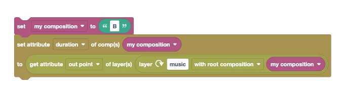

Expressions can only change the value of the property they are applied to. They cannot change the duration of a comp or anything else in your project. What you need for this is to write a script. The simples way to write scripts is using my extension Automation Blocks, which is currently in free beta testing phase:
https://aescripts.com/automation-blocks-for-after-effects/
With Automation Blocks you use blocks instead of programming code.
This example searches for a composition with name "B" and for a layer with name "music" inside that comp. It then sets the duration of the comp to the duration of that layer.
