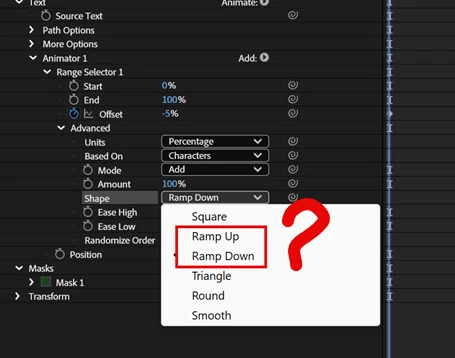

Ramp Up & Ramp Down
How to distinguish deference between Ram up & Ramp Down here? In the real word if you start from lower point it is ramp up & if you start from higher point it is ramp down.

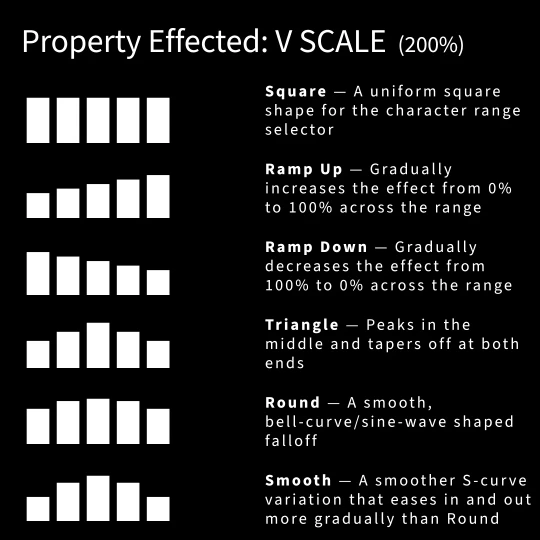

    thepixelsmith
    May 1, 2026 3:00 PM UTC
    I made an image to illustrate the difference between the different effects of the Shape property of a text animator.
    Jerron Smith | www.thepixelsmith.com

    Apr 29, 2026 10:23 AM UTC
    The advanced animator shape controls affects how text is changed on a per character / per word basis (depending on Based on).  Square does each character in turn.  Ramp Down starts affecting the second character before the first has completed and the third and so on.  Ramp Up is a little odd, as it sort of goes backwards.
    Imagine if you had a word made up from scrabble tiles and you had a wooden block to push them along a table.  Square is like pushing the block straight.  Ramp Down is pushing with the block at a 45 degree angle.  Ramp Up is the opposite angle.  Triangle pushes from the middle, Round… also from the middle but the pusher is a plate.  Smooth… yeah, I’ve run out of analogies.
