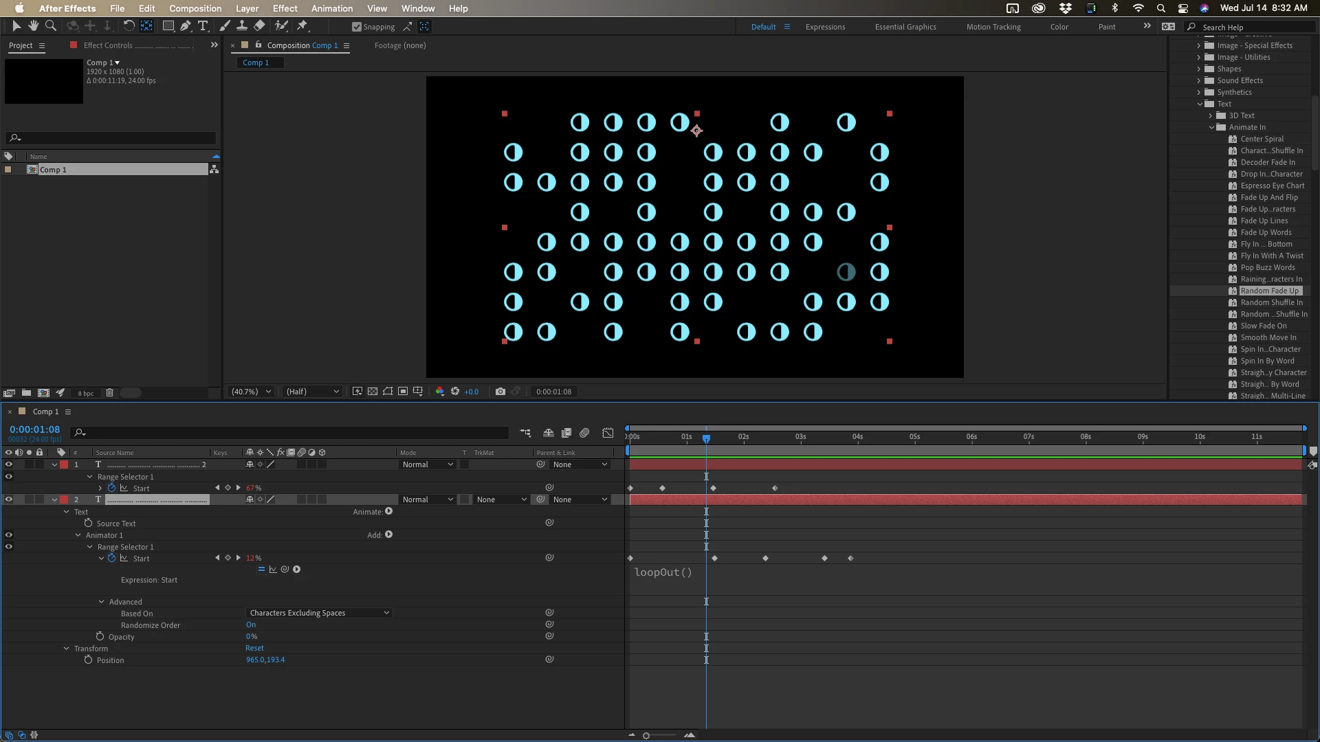

If it is just a simple dot pattern I would use a text layer:
Then add an opacity animator and set that to be random. There's already a couple of random text animation presets that could get you started. The Text layer is going to render a lot faster than a shape layer with a lot of dots on it. This took me under 2 minutes using a cool font and adding a bit to the Random Fade Up Text animatiion preset.
OussK
