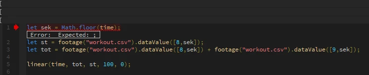

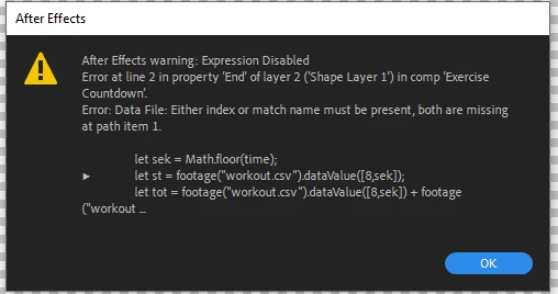

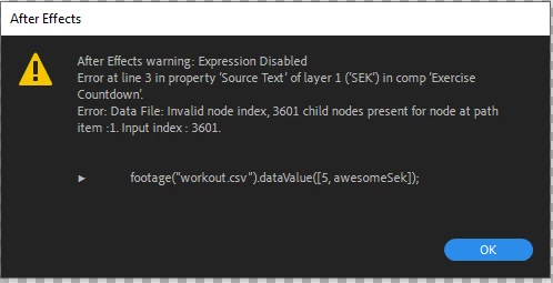

I still seem to be getting some errors like this:
This one can happen for a lot of the layers with expressions. Note that "awesomeSek" is just from me trying different variable names because I thought I might have some collisions. This one can happen at the very start as well as the very middle of the timeline. I don't know why, because the length of the composition is the same as the CSV file. I don't quite understand it either. Is it saying that it tries to get index 3601, but that there are only 3600 present?
This one is fun, I think! It expects a semicolon, but the semicolon is already present. The expression also works perfectly fine.
This is the last one I have managed to get a screenshot of. Something is missing here, apparently, but not on the next line where the expression is basically exactly the same?
I don’t quite understand all these errors, and they appear and disappear randomly. I find it hard to pinpoint a cause. They can be there for one layer, and if I hop a few frames forward they disappear. Later the same error, or a different one, appear for a different layer, or the same.

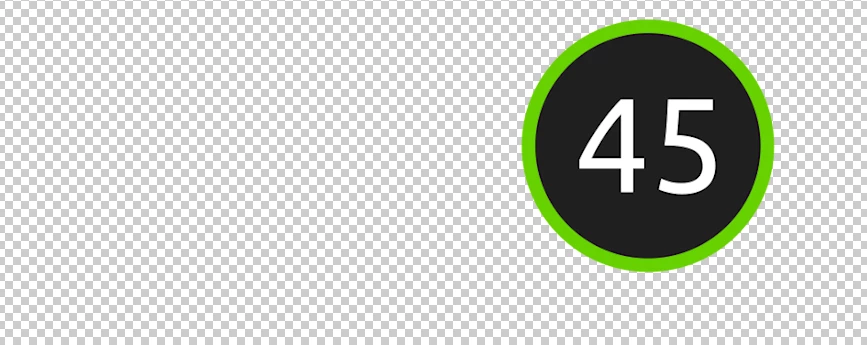

Problem 3: No expressions are rendering in AME
When I do test renders losslessly, or in fact using any codec, straight from After Effects, everything shows up. When I try to do it from AME, nothing seems to work. The layers are stuck on their default settings (expressions not executing) or layers are just gone. Sometimes AME just hangs forever. It can hang while trying to connect to dynamic link with a progress bar at the bottom, but it can also hang without any progress bar and just nothing happening. I am trying to render using h.264.
Here is an example of expected result and actual render the few times I get it to work.
It can also be that the layer is visible, but static on the default value because the expressions are not evaluating.
