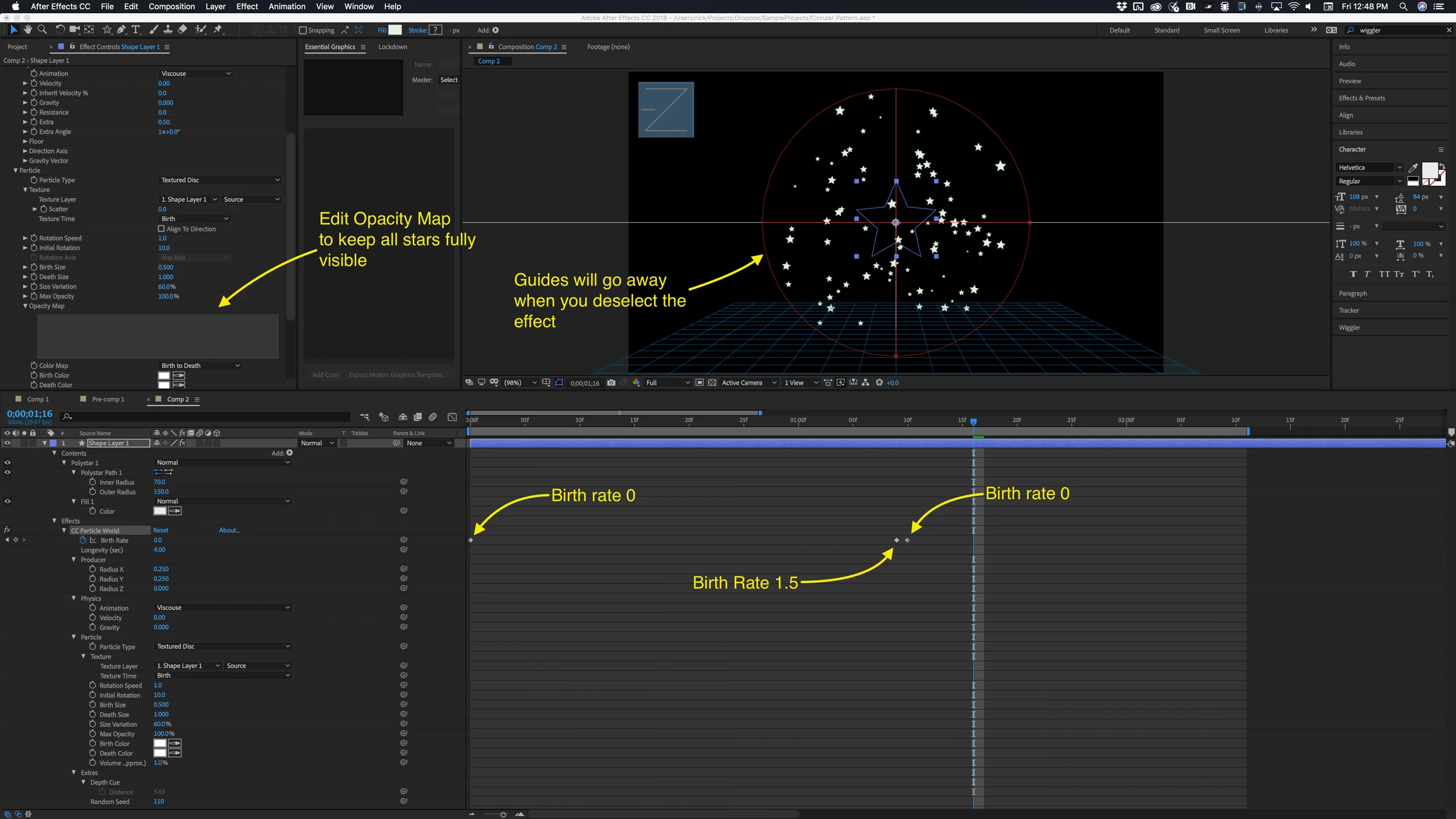

I would use CC Particle World. Create a single small star on a shape layer, add CC Particle World and make these adjustments. The X and Y radius determine the size of the circle:
Using multiple shapes and a few expressions is also possible but it's going to take a bunch of work and fiddling around. Unless the stars must end up in s specific position and have a specific number, this is probably the easiest solution. Playing with the random property at the bottom of the effect will change the shape of the pattern.
When you get the stars the way you want them, pre-compose moving all attributes then use the Layer>Time>Enable Time Remapping  (Alt/Option + Ctrl/Cmnd + t) then set a keyframe at the time you want, press K to move to the last time remapping keyframe and delete it.
There you go. Should take about 10 minutes.

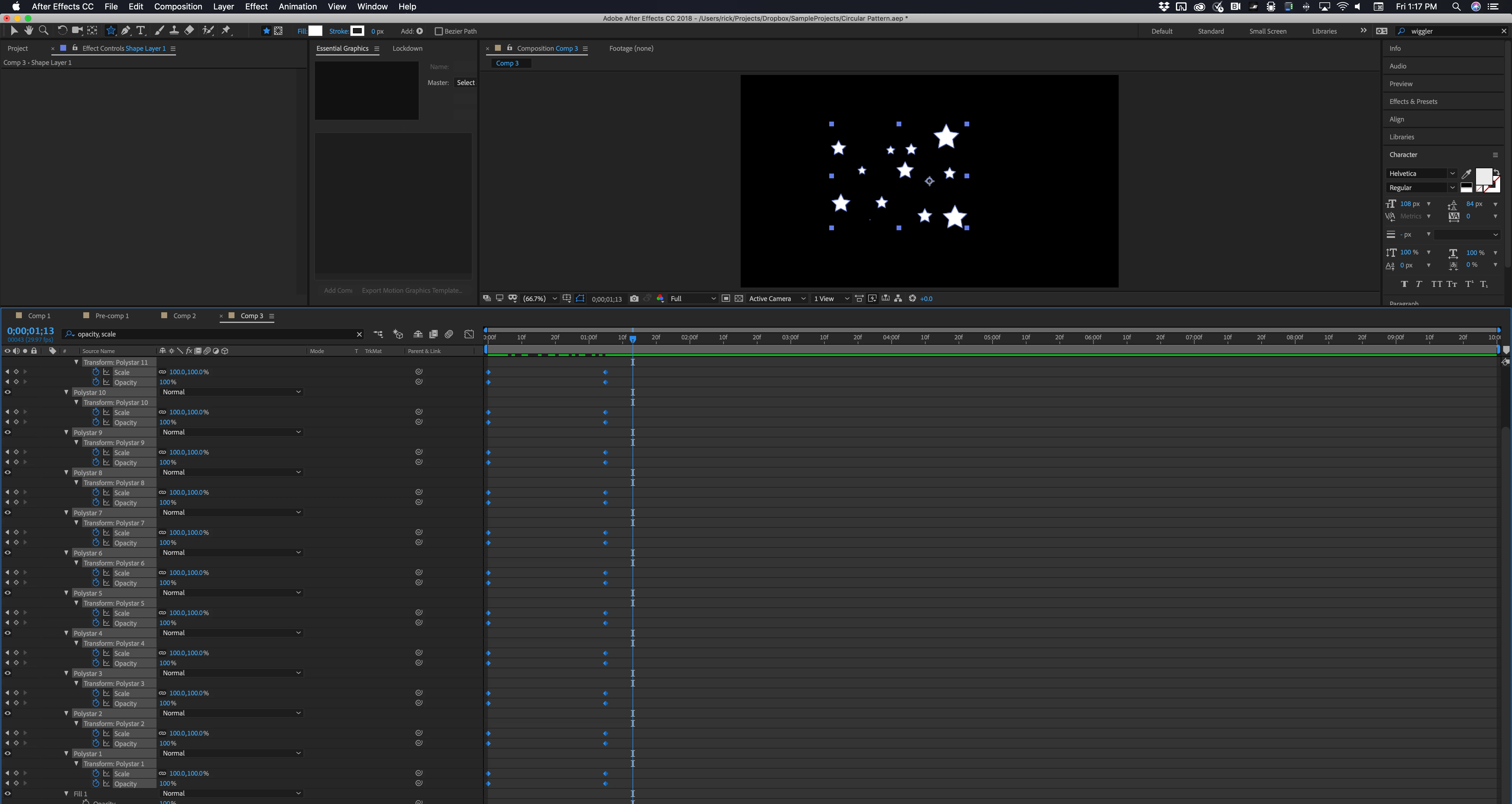

If you need specific places you can put a bunch of stars, all on a single layer, in the place you want them, press the U key twice to reveal all modified properties, then set keyframes for PolyStar>Transform Polystar>Scale and Opacity, then just drag the keyframes around in the timeline. Here's the manual workflow.
  • Select the PolyStar tool and draw as many stars as you want on a single shape layer
  • Type fill in the search field and select all of the Fills for all polystar shapes in the layer and delete them
  • Type stroke in the search field and select all of the strokes in the shape layer and delete them
  • Use the Add button to add a new fill at the bottom of the shapes stack
  • Type opacity, scale in the timeline search field to reveal all of the Polystar>transform> scale and opacity properties
  • Drag a selection around all of the scale and opacity settings and set keyframes for zero and zero
  • Move down the timeline a few frames and set new keyframes for scale and opacity of 100
  • Start grabbing keyframes in groups and slide them around the timeline to randomize the appearance of each star
That's about it. The search field in the Timeline makes it easy to find the properties and set a bunch of them at once. Here's what that looks like:
