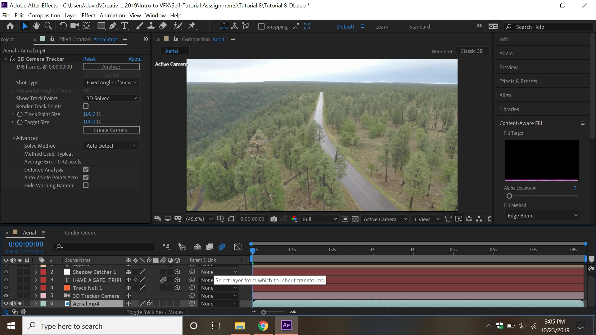

    As you see right here, I'm supposed to select the "Aerial" layer in the timeline and that layer has the 3D camera tracker thing in the project panel. And yes, the "Render Track Points" is disabled as it was supposed to be, but now that it's disabled, I couldn't see the track points anywhere on the footage here.
    If you need more clarification for this situation, I will try to add more screenshots to this.

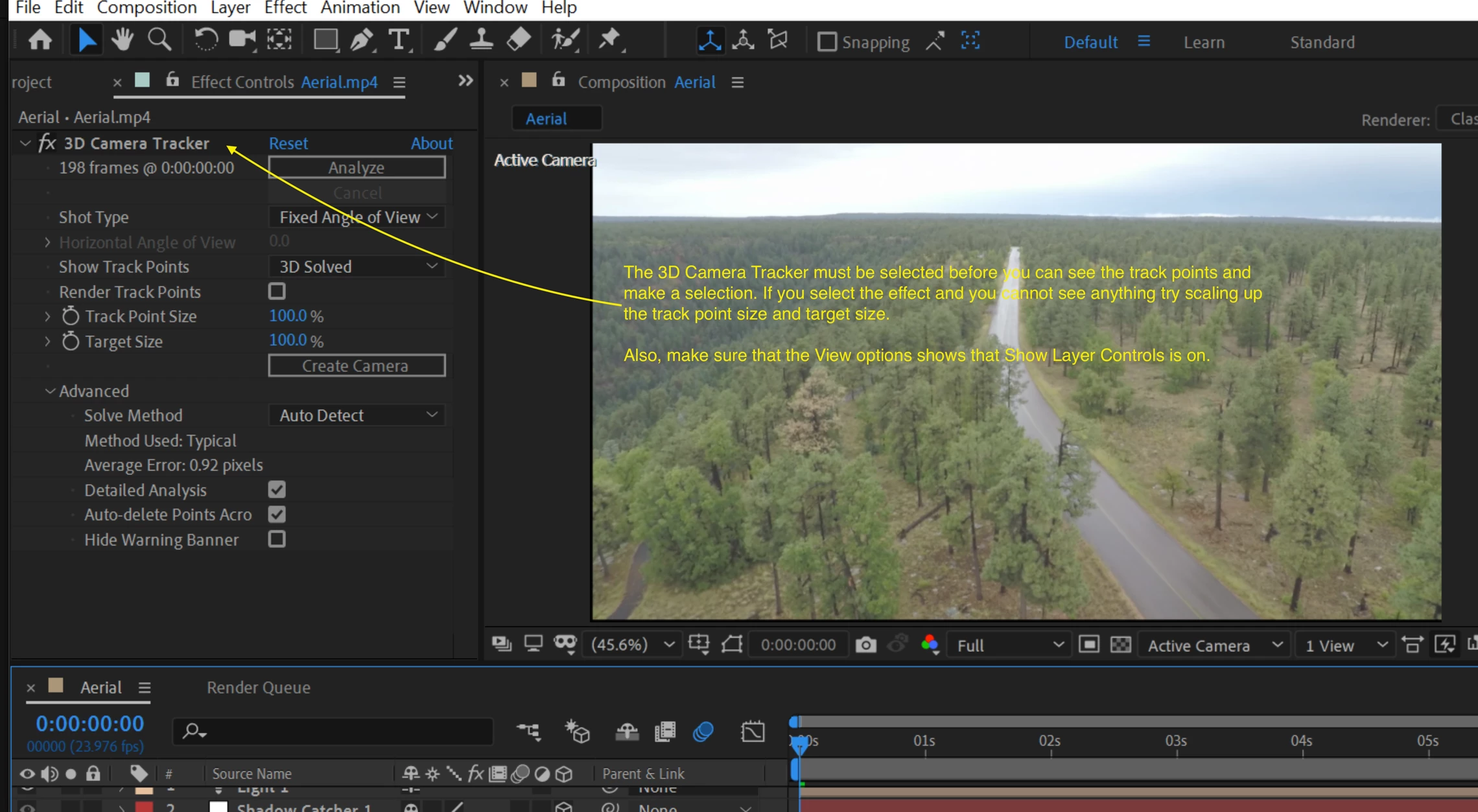

    You do not have the 3D Camera Tracker plug-in selected. See the screenshot:
