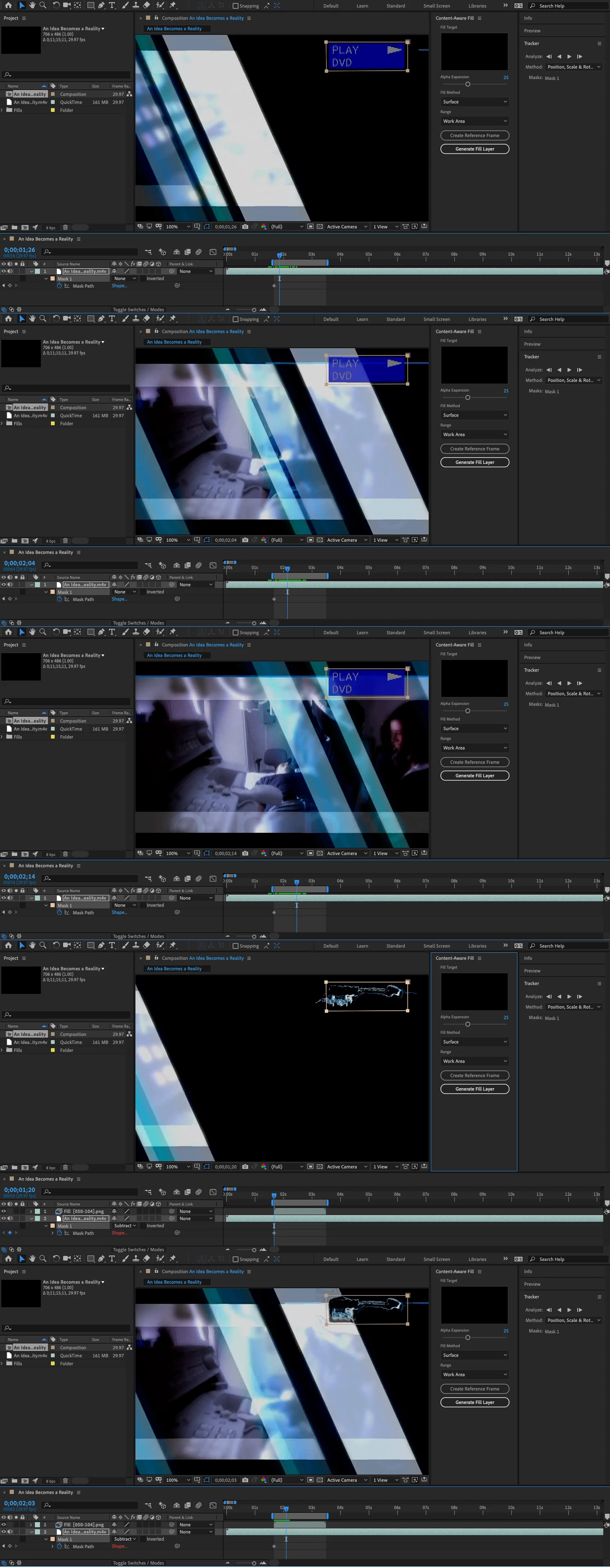

    This sequence illustrates my description.
    The menu "PLAY DVD" is in the upper right.
    I've made a mask of it.
    The first three frames show images from the clip's sequence.
    The last two frames show the fill generated. Note that they are just "smears" of pixels.
    Is this example just a special case that "Content-Aware" can't do, or have I made a mistake in my procedures?
    Thanks in advance.
    -Robert
    April 11, 2019
    Robert_Edgar Your project is a perfect example of a time when you need to create reference frames. The hard black edges are throwing the predictions that content aware fill is trying to make.
    I would start the content aware fill where the first image just touches the first image, then add as many as are necessary to clean up the rest of this clip.
    The video you are trying to repair is not a normal shot by any means so the predictions are not going to be very accurate. That's why you need to include a bunch of reference frames. There are some pretty decent tutorials on how to fix those kinds of problems.
