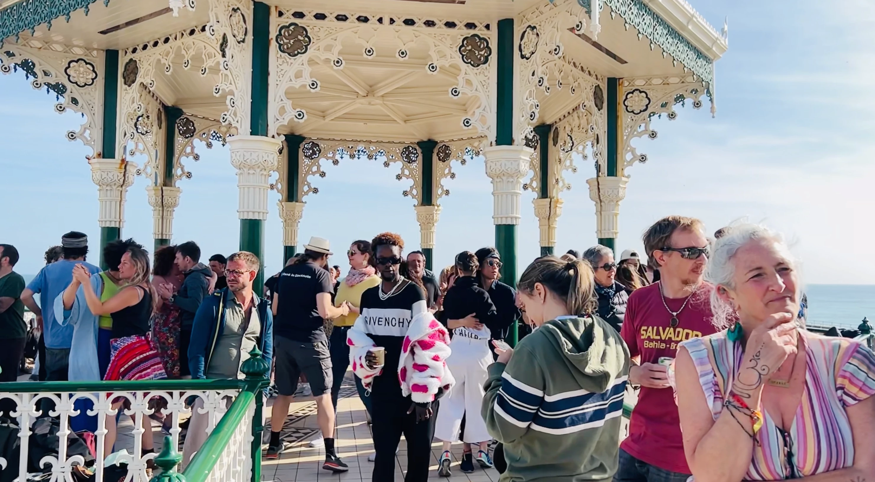

here's a screen shot, cant seem to upload clip ... The guy in the centre, needs to removed bc he gatecrashed the event, was a pretty wasted and was wearing a labelled top, but its a great slow mo shot, so wanted to use if at all possible. Thanks for advice, Im managing to make mask, track it, but it seems the background gets messed up.  Also, I cant seem to export the final results.

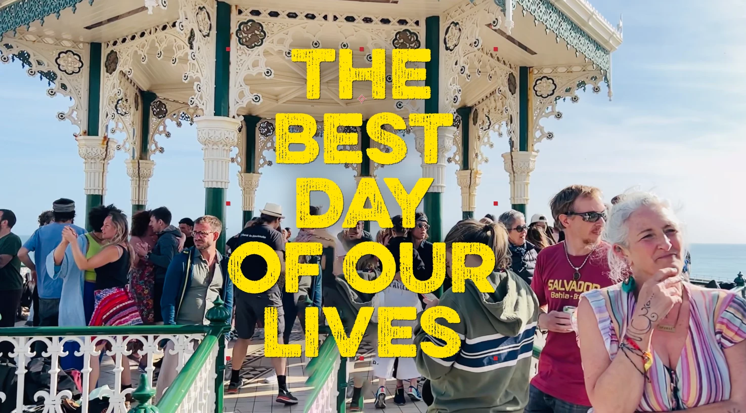

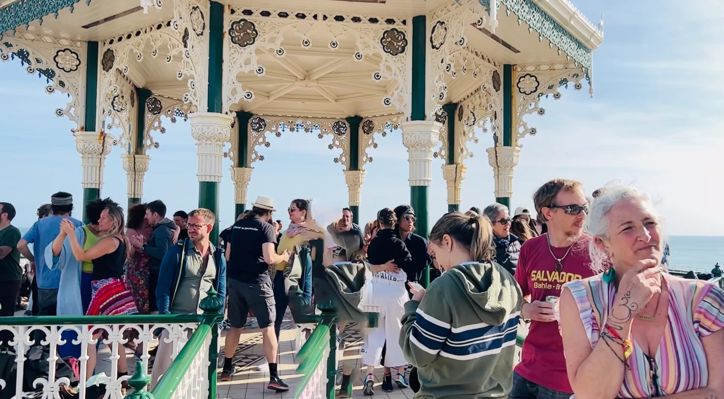

Unfortunately the scene looks too complex for CAF to be effective.  I did a CAF on your single frame and it's obviously a bit of a mess.
But you could potentially save the shot by getting creative.  If you can use it in your edit as a background for a title, or something, you can draw the viewer's eye away from the problem area.  Just a thought, without knowing what your footage is really like.
